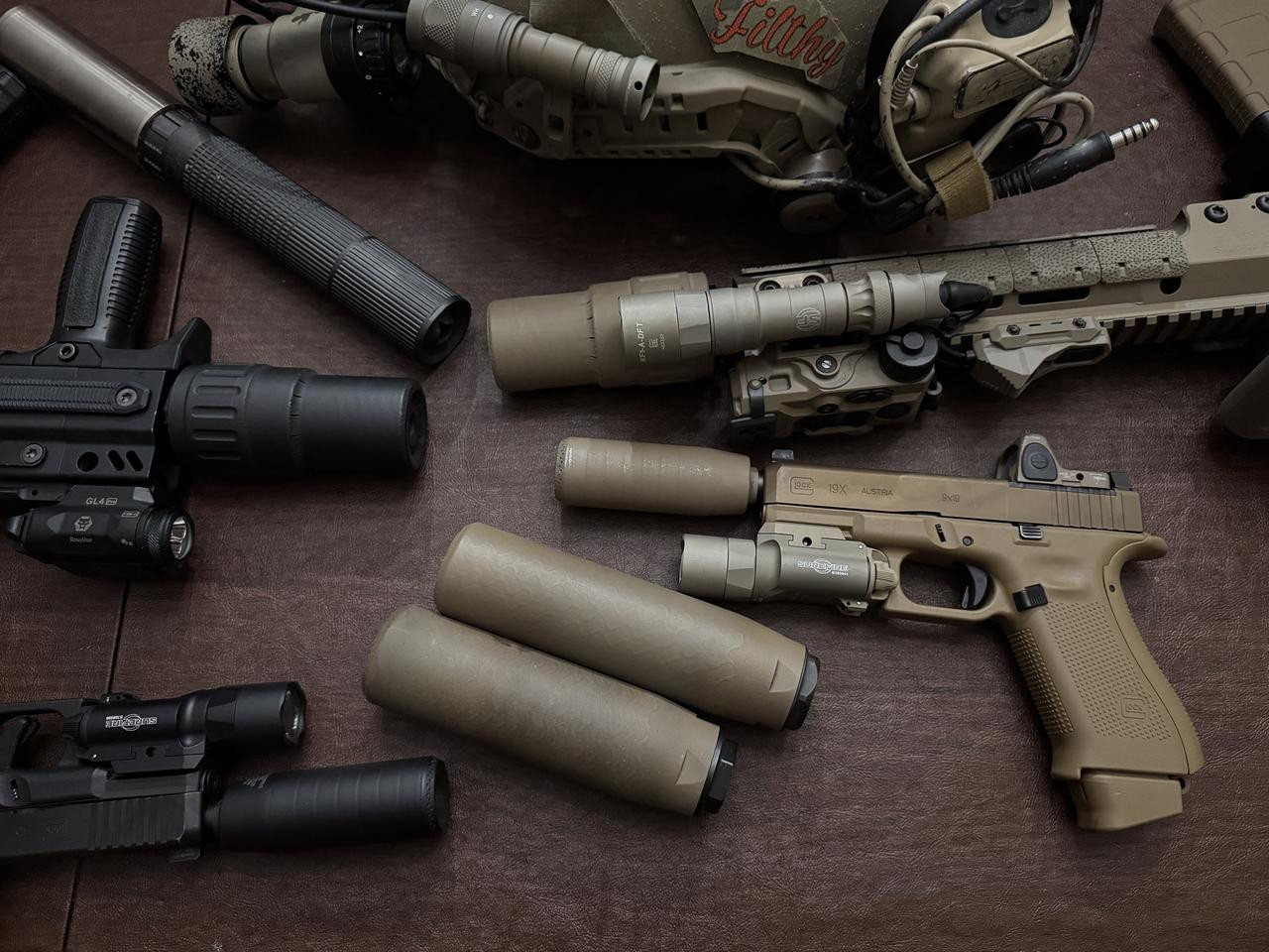

A friend and I went out last weekend with the intention of comparing a whole mess of cans and hosts. We learned a lot, dispelled some notions and had some others reinforced. Our testing was performed in the desert at sunset in calm conditions at around 110°. We were shooting up against a mountain with no berm per se, so there was echo. We shot the rifles both into the mountain, and down into the ground about twenty feet in front of us to mitigate sonic crack.
All 9mm testing done with 147gr flat nose Blazer Brass.
All 5.56 testing done with PMC XTAC 55gr.
9mm handguns -
Hosts:
Glock 19X
M&P 2.0
Beretta 92FS
CZ 75 SP01 Tactical
Cans: Incolite 9M, Cat Street Crack, SAW Shiv.
Takeaways & Impressions –
We tried to bring a range of hosts, and found that performance was very host dependent, moreso than expected. On some hosts, some cans were a little quieter than others, and then we would migrate them to different hosts and get different resultss, so my impressions are kind of the averaged-out result. We left the modular cans in full config for simplicity and time constraints.
The Street Crack is incredibly quiet. The Incolite 9M is the poor man's Street Crack being basically just as quiet but with a slightly higher, ringing sound to it whereas the Cat has a thumpier, slightly deader tone to it. Honestly, averaged over all the hosts, it was almost splitting hairs between the two. The difference in volume was negligible, it really just came down to the tone. If you have the budget for a Street Crack, get one. If you have the $475 for the Incolite 9M, get one and know that you're getting about 95% of a Street Crack.
The Shiv punches way, way above its weight class. It isn't as quiet to the bystander as any of the pistol cans tested, but it was also less painful to shoot than most of the combinations with no ears on. That backpressure thing is no joke. For what value I can concievably place on suppressing a handgun, it's the winner. I want to take the bite off my house or competition gun without meaningfully messing with the balance, or introducing more shit that can break or carbon lock with a booster. The balance thing cannot be overstated, the other cans, even without the extension modules, feel like hanging a brick off the front of the gun in comparison. I think the Shiv is also the only can that never peppered me in the face with any of the hosts tested, and hasn't yet to date since I got mine back in March.
I used to own a Phoenix TL, and was shocked to come away from this feeling like the TLX finished squarely in the middle of the pack in terms of volume reduction to the bystander, and being comfortable to the shooter. However, if someone were looking for a boosterless lightweight can, I would just get a Shiv and be done with it unless you have some funky thread pitch needs, and then I think the TLX is actually still a solid choice in 2026. Ecco gets a lot of love on Reddit for mounts and such, but people sleep on his suppressors. They were more of a fantastic deal about three years ago, but they're still worth a look today.

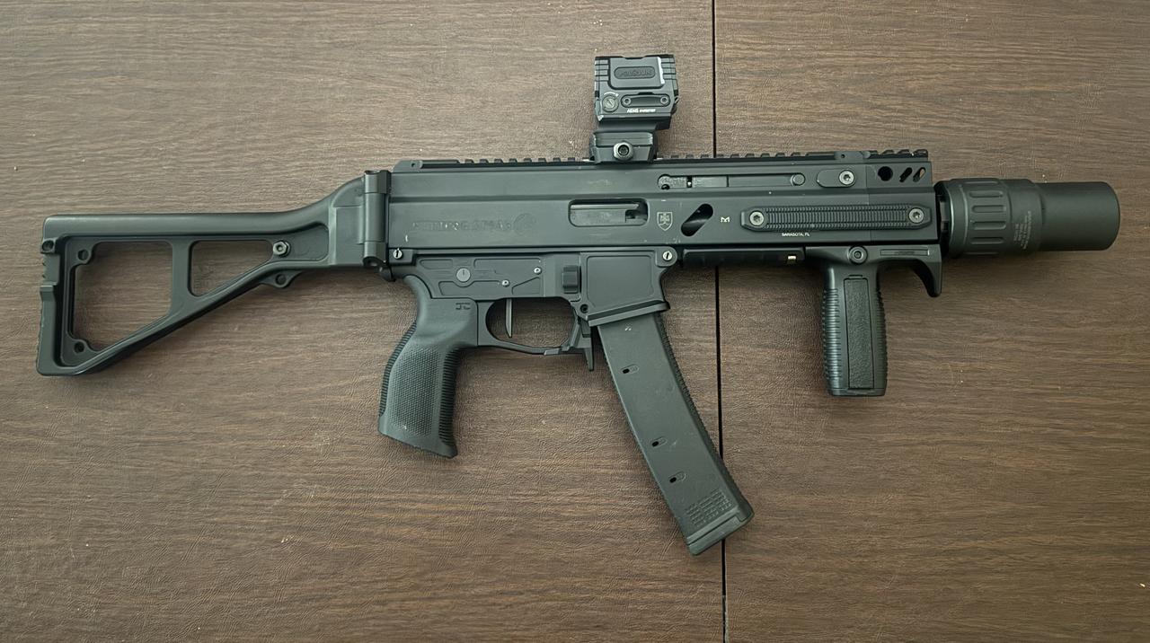

Cans: SAW Tisha 9mm, CAT MOB, CAT SC, Incolite 9M
Takeaways & Impressions – Everything was quieter on the CMMG, both to the shooter and the bystander. It's just a quieter system, and that's with the 35° locking block and KD Gunwerx buffer system in the Stribog. If you don't Stribog, that means it's about as tuned as it gets for suppression. The Cat MOB on the CMMG was the quietest combo tested, but the Street Crack and Incolite 9M were honestly right up there with it. It was awfully, awfully close between the three. The main differences came down to tone – the Incolite has a slight higher pitch ring to it that the CAT cans do not. Again, if you have the $475 for the Incolite 9M, get one and know that you're getting about 95% of a Cat MOB.
Though the Tisha 9mm was not the quietest to the bystander on either gun, it was easily the quietest for the shooter on both hosts. It's especially notable that it was the only can for either shooter that had zero bite on the Stribog, mainly due to how obvious a difference there was between it and the RDB in terms of backpressure and port pop. There was enough backpressure with all the other cans that I could only handle a round or two with no ears on with the Stribog, but the Tisha was very comfortable. The 9mm Tisha will be living on my Stribog going forward. I've shot several RDB's before, and they always impressed me with how quiet they were. I think I'm sold on doing an RDB/Broad River Tactical integral build with the Incolite after this. RDB's tame port pop incredibly well.

Replying in a separate reply intentionally. I wrote that report as soon as we got back so it was all fresh. After a week to let it all percolate, I have to say I'm incredibly impressed with the Incolite 9M. I would say it's currently the big market disruptor in the pistol can space. We are hoping to get back out this weekend or next weekend to compare a bunch of other cans if we can get the turnout.
What I didn't get into in that writeup is that in the dark, somehow it got missed that there was some kind of crud or carbon or maybe even bits of jacket on the threads of my friend's BRT integral extension when he threaded my Incolite on there. We could not get the Incolite off, hence the extension in the picture. I brought it home and tried all the tricks. I froze it, hit it with a torch, shredded a strap wrench on it, wrapped a silicon gun cleaning mat around it to tighten as I tried to thread it off, everything I could think of it and it would not budge. PB Blaster did nothing.
I contacted BOE Suppression and talked to their head of sales and he wanted me to send it in, but not before saying "whatever BRT made that tube out of, I'm pretty confident the threads on it vs Inconel... the Inconel is going to win." So, to potentially save myself the shipping, I tried one last thing.
I 3D printed a vise block out of PETG with 98% infill to fit the extension, cranked that fucker down in my heavy vise, and wrapped the silicon mat around the Incolite, and gave 'er with the strap wrench. It started to move, and I kept with it. Sure enough, it came free and with zero marks on the threads for the Incolite, but the threads on the BRT extension are chewed. I will need to check to confirm, but I think it is 17-4 stainless. Bits of what look like copper and lead came off in the paper towel, and I can only guess what happened there. But the bottom line is, Inconel is some really stout shit.
The 9M with the extension mounted is absolutely, ridiculously quiet. I'm going to get back in touch with the sales head at BOE with some feedback about how it fared vs the CAT cans that it's obviously gunning for. I think it's every bit as quiet, but there's a bell-like quality to the can that, if they can deaden it, will have it giving pretty much exactly the same performance at less than half the cost. It really is unbelievable.

Bryan, the MOB is an excellent can and if you wanted the modularity of the Street Crack, the Incolite 9M gets you awfully close. For the money, it’s pretty unbeatable.
As for a Tisha on an AK, I haven’t tried one, but I have used the .30 cal Ekron on an AK and it sounded great. It was very, very quiet, especially with subs. Mainly what I heard was the action cycling. The Tisha isn’t as quiet as the Ekron, but it’s damned close, and it would look right at home on an AK. Since the Tisha and Ekron are comparable in terms of overall suppression and backpressure, I would say it probably does really on AK’s. Given that my experience with the 9mm Tisha was so similar in terms of results compared to the 5.56, I’d wager the .30 cal version performs similarly. They are essentially the same can, after all. Since the 9mm is rifle rated, I was thinking I might also see how it does on some rifles next time out. Apparently the 5.56 Tisha is absolutely phenomenal on an SBR’ed PS90, and I’ll be trying that out as well.
