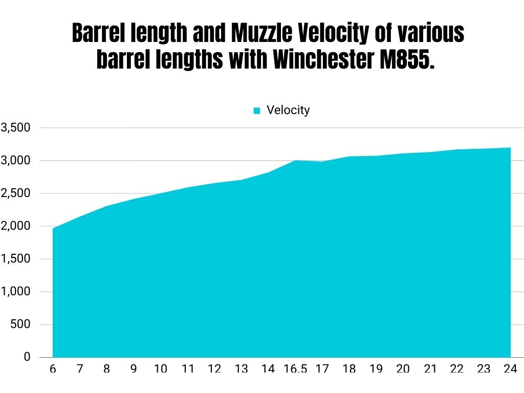

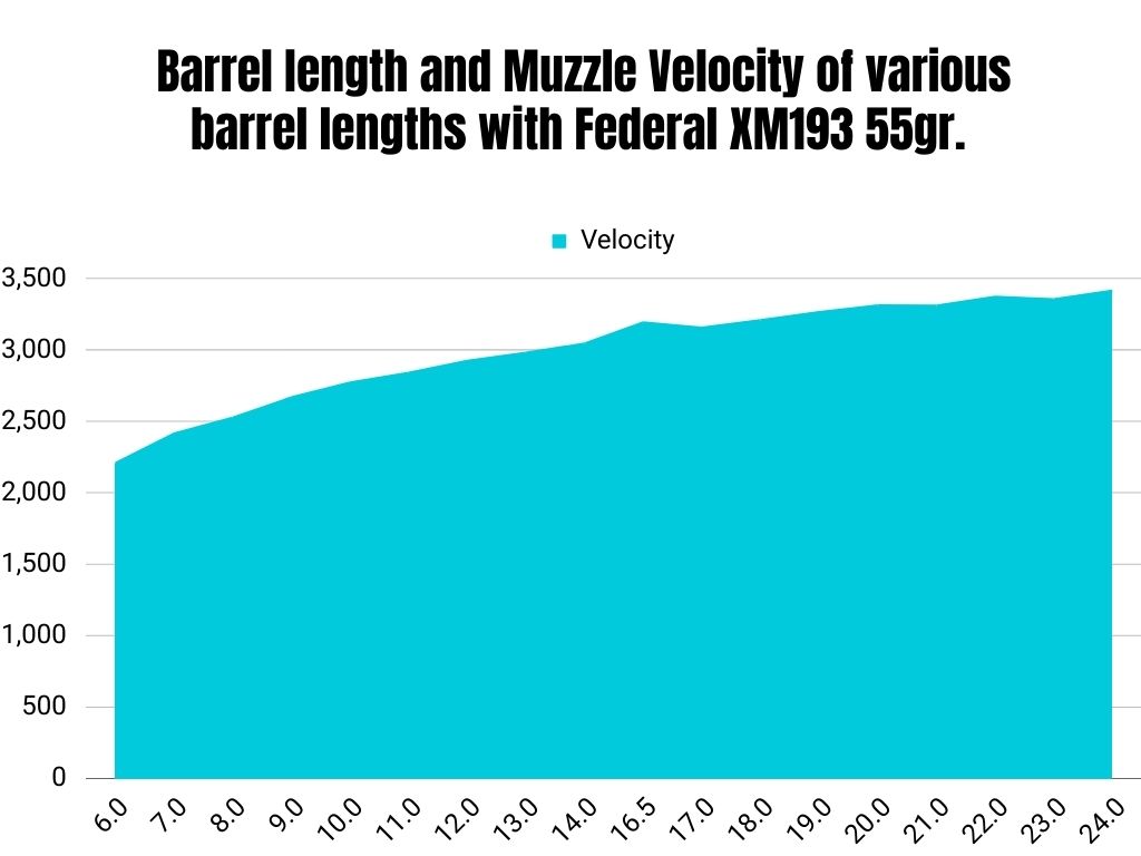

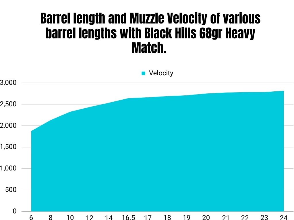

I pulled some data and graphed it out. I'm not going to embed, it's just going to take up too much space for an imperfect test, but the data is interesting to look at.

When you look at it, some patterns start to emerge. From 10" on down, you lose velocity rapidly. It's a fairly normal increase per inch from 10" to about 13" and a good jump at 14" with M855. 16.5 (which is a weird number to graph vs just 16", but it's what I got pulling from the data set) stands out as the biggest single increase in velocity throughout all the lengths tested with the increases past 20 being... debatable.
So, practical application: if you have an SBR and can shoot any barrel length you want because the can you chose allows it, then it's a matter of inches and ounces and I think some "sweet spots" do emerge. When you go from 10.5" to 11.5" or 12.5", you're not adding a lot in terms of handling, but you are getting anywhere from 100-200fps in velocity. From 13" on, you get some good increases, but if you're going to SBR a rifle (or use it as a pistol), then you might as well go shorter than a barrel length you could just pin and weld for, right? You could pay your $200 to have a 13.7" or 14.5" that you don't pin and weld just so you can easily change muzzle devices, but most people don't have money to throw around like that. I have a 14.5" pin and weld and it handles more like the 16" I have. The 11.5" inch gun with an A2 length muzzle device feels like a much smaller package overall and doesn't give up a whole lot of velocity vs 14".
