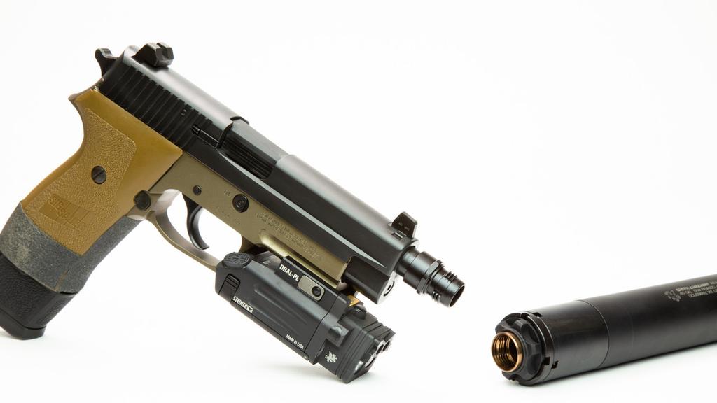

Possible to use 3-lug mounting with a booster or are boosters only compatible with specific threaded pistons? Any such thing as a 3-lug piston?

as both Dwill104 and I said in the other thread neither of us have heard of such a thing. But in the universe its always possible, but I don't for the life of me see how one could design such a thing, you need a spring for the 3 lug to be tensioned and then inside that you need the neilsen to have a spring and be free to move.
And to cut to the chase you don't want to hang a 3 lug muzzle device on a 226 anyway. There are a couple of ways to get a qd that has a booster but really none of them make any sense on a pistol.

The short answer is no. Get a tri lug mount, get a booster mount, get a wrench for those mounts, and swap them out as needed.
There are things like the Griffin EZ Lok ecosystem and fixed spacers, but that’s getting into a can of worms, and given that you’re dealing with Sigs and that reverse thread 13x1 stuff, I just don’t know.

If the purpose is to not have to swap adapters or a spring for a fixed barrel spacer, there are some small very lightweight 9mm direct thread cans like the SAW Shiv that claim to not need a booster. You could, in theory, run a can like that using direct thread on both your Sig P226 and MPX, assuming the barrel thread pitch is compatible with the suppressor thread pitch. I believe the Shiv only comes in 1/2x28, but there might be other cans that come in M13.5x1 LH.
Of course, a can lightweight enough not to require a booster is going to give up some sound performance.

Just to combine it. For a P226 to have QD there are essentially three options. Silencerco's proprietary system for their vaporware S98, and Griffin Armament's two options. EZ-Lok and Cam-Lok.
Silencerco' S98 is specific to 9mm handguns and no M13.5 thread adapter for the S98 mount is available. If you swapped the standard MPX-K barrel for one threaded in 1/2x28, you might be in business, as the S98 is boosterless. That being said, I don't even see 1/2x28 S98 mounts on their site, hence the vaporware comment.
Other's mentioned Griffin's Cam-Lok and EZ-Lok both have a plethora of thread pitches, however, if you are taking the booster out to replace the piston spring with a fixed barrel spacer anyway, you lose the true QD you're looking for.
Manufacturers just need to start selling integrally suppressed pistols from the factory, like the Maxim 9, except reliable and under $1k.

The big problem with any of the options that do kind of what you're getting at is you're adding shit to a threaded pistol barrel that has to come off if you want to disassemble your pistol beyond separating the slide from the frame. Leaving this crap on my gun is why I decided to pass on the Griffin EZ Lok a friend loaned me to try out.
A thread protector, some O rings, and plumber's tape makes it all much cleaner and more manageable, imo.
Griffin makes a tri-lug system, but do you really want this hanging off your 226 when you're not shooting with the can mounted? I don't.
And again, you'd need to install the fixed barrel spacer to the mount in the can anyways when you're swapping it over to your MPX, so you're not really saving yourself any hassle. The only real benefit to this stuff is being able to mount a can on the pistol very quickly, which... I just don't see the point of. I just leave the thing on there unless I need to transport it in a case that won't allow a pistol with a can mounted. Tri lug on little subguns is nice for that exact reason, and the ways people typically employ them. Even then, I've gone to Plan B stuff on my Stribog.
