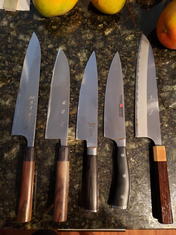

I am curious about the appeal of what I presume is the Japanese style handles on large kitchen knives. It would seem to me that the relatively thin oval shape of the ones I’ve seen would make them harder to hold firmly and control precisely. (I am becoming more aware of such things as my hands become older and more arthritic.)
What am I missing?

Balance

The handles on the Japanese blades are larger than you might assume:
For comparison from left to right is an Anryu, Kajiwara, Shun, Wustof IKON, and a Richmond Laser. The Richmonds are Chefknivestogo's house brand imported blades with custom handles. You can get different variants of the handles if you want.......
