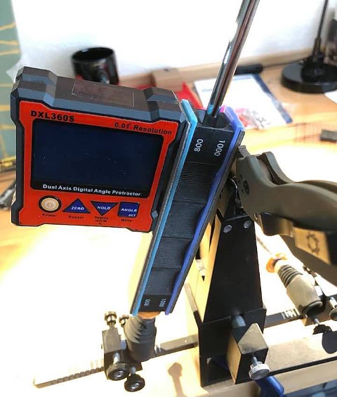

Using my angel cube (TIP; only use one platen side to take your initial measurements, I used the 1K side) the Left side measured 17.70°; the Right side measured 18.43°

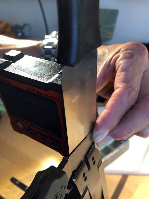

Next I take a 1.5" putty knife and butt the Angle cube up against it, I rest the putty knife & angle cube next to the blade on both Left & Right side and record the readings.
Think of the Left side of the WE as your positive side and the Right side as the Negative side (that's how I remember it in my mind).
On the Left I got a reading of 1.74° (positive); on the Right I got a reading of 2.81° (negative); Add the positive reading with the negative reading and I get 1.07°; next I divide this by 2 = .53°
Add .53 to the initial Left positive side reading 17.70 +.53 = 18.23°
Subtract .53 from the inital Right negative side reading 18.43 -.53 = 17.90°
I add these values together; 18.23 + 17.90= 36.13 inclusive; I divide this by two = 18.06° DPS

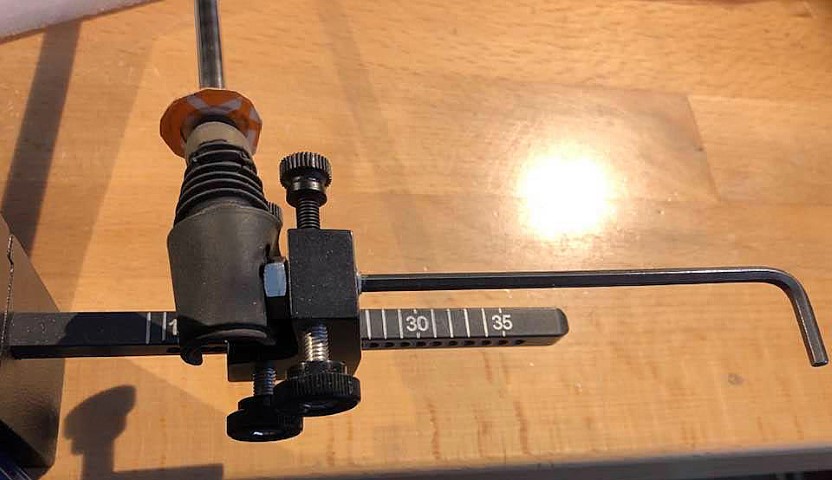

NOTE: I'm able to dial in my angles precisely with my setup (using the WE Field & Sport with adjustable pivots).

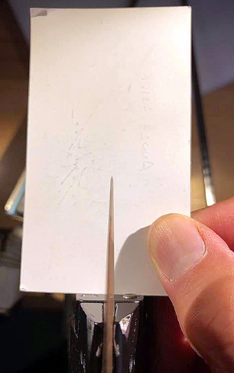

As you look down on the apex of the blade you should be able to see at the tip which side may need more grinding to get you to where you want to be, it may take more than one sharpening. I use the back of a business card (white background to view the apex at the tip of the blade).

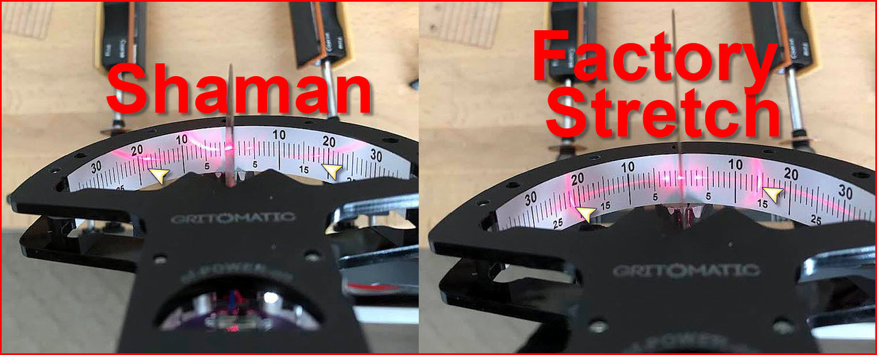

Goniometer: the image below illustrates a Spyderco factory blade for a carbon fiber Stretch model and a Shaman model that I sharpened using the process above; my goal for the Shaman was 18°DPS Wink

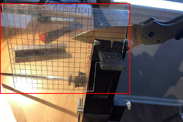

I'm including a link to a video on finding the sweet spot, I use a rolled up hair-tie rubberband that I can move down when its not in use.
Finding the sweet spot
