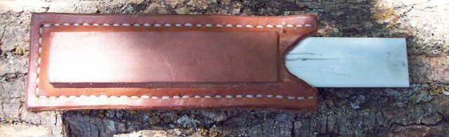

Spyderco Double Stuff in a homemade sheath w/strop attached.(idea stolen from some guy on YT years ago)
