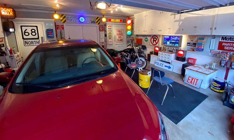

Hey don’t discount drywall.
It can be nice as well ! Big Grin

Grumpybiker, that’s a beautiful garage but mine is my reloading room, work shop, wood shop, and everything else shop. I don’t have a basement or out building and after a while the netting holding the insulation gets torn and is a pain in the neck.
