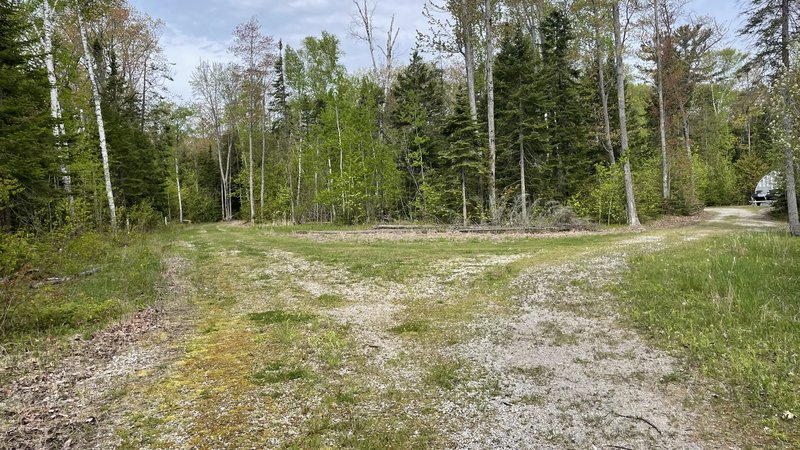

The picture represents the worst part and it’s probably 2,000 feet long plus some large parking areas.
I’ve got a 20 gallon tow behind sprayer I’m going to use to kill the weeds.
Besides the sprayer, I have a Polaris Sportsman 800 ATV. Kubota RTV900 UTV, and a propane powered weed torch. I’m thinking I can burn the weeds when they dry out after the weed killer.
I’d like to smooth things out from the crown to the sides and fill a few low spots.
I’m thinking about a tow behind grader like this: Link.
Or should I rent a tractor and a box blade?
What’s the cost effective way to tackle this?
It didn’t look this bad last year and looked a whole lot better than this after I sprayed the weeds.

A tractor and box blade would probably be the most cost effective.
It doesn't appear that you have any serious potholes, but if you do, filling them is NOT the answer. You need to rip the entire surface below the bottom of the pothole and re-grade.
You know about the need for a crown. Tilt the box and cutting the edges, dragging the spoil towards the center, then level the box and drag the center out to get the crown.
The secret to getting good results with a box blade is adjusting the top link properly. Shorten the top link (tilting the box forward) to get it to cut and move material, lengthen the top link (tilting the box rearward) to level and smooth.
I've had a hydraulic top link on mine for several years, makes it easy to adjust fore-and-aft tilt on the fly. This year I spent the time and money to fab up an hydraulic side link so I can tilt the box side-to-side for cutting the crown without having to get off the tractor and crank on the manual adjustment.
If you can kill the weeds effectively and cut the sides enough to put a good crown in it, you may find that you don't need much (if any...) extra gravel.

More specificity is required when talking about "gravel." This can be anything from round river stone to a substance similar to sand. Looks like what you have now is pea-sized marble chips, nice and clean looking, but not the ideal material.
What is best for most unpaved driveway applications is usually called "crusher run," that being the raw unscreened output of a rock crusher. Get it from a quarry rather than a "gravel pit." Because this product has a range of sizes of rocky material, it compacts far better than any uniformly-sized "gravel" product. And, because there is no after-run processing, it is usually far cheaper the most products sold as "gravel."
You want to spread it about 2-4" thick over your existing driveway, level it, then compact it, preferably with a vibrating roller or vibrating plate compactor. No need to remove weeds before hand (but it wouldn't hurt to mow it down tight). Renting and running the compactor is going to be the hard part assuming the use of appropriate power equipment for hauling, spreading, and leveling (loader, grader, and screed). An experienced operator can do a half-decent job of spreading and leveling with a loader bucket, but, as usual, use of the proper tools results in a much nicer finished job.
A thicker coat will require multiple layers to get the compaction needed.
A properly compacted crushed stone driveway looks and lasts almost as well as asphalt with far less preparation and maintenance.

You’ll want something with dust in it like 304 etc to fill in pot holes, low spots etc and water and roll it, then top with something like 57s. If you just blade the top gravel you have into the holes etc, it’ll just get rolled out eventually by just driving over it. It’s hard to tell exactly what you have there so take what I said with a grain of salt. There may be enough base under there to rough it up and get what you are after but probably not likely. You’re on the right track by wanting to crown it or even tip it where it’s can be tipped to shed water. You can probably do it with a box scraper . I’ve done a lot of roads and getting a good base is the number one objective. If you have access to a skid loader, you can do wonders with one of those also.Stone went thru the roof down here so you really aren’t out anything attempting to straighten up what you have first, it’s always easier to add some where you think you may need it then to get too much on the job. If I was closer or gonna be up north soon, I’d offer to swing by and do it or get you headed in the right direction, let us know how it turns out! A grader will do wonders but I understand it’s not always practical or feasable

Call the quarry and tell the dispatcher you want a driver that knows how to spread his load. When he gets there have him spread it about 2” thick and drive over it a few times (most will do that if you ask nicely). Then use a blade on a tractor, not a box blade unless you know how to use it and Bob’s your uncle.
You will probably have to get several loads of stone to accomplish what you want.
