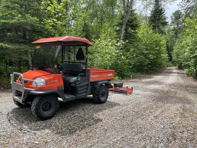

I’m getting a handle on it:
Got up here Tuesday night, put the grader together yesterday, made a few passes until it started raining, and ran it for a few hours today. I’ll be getting some better weed killer tomorrow.
