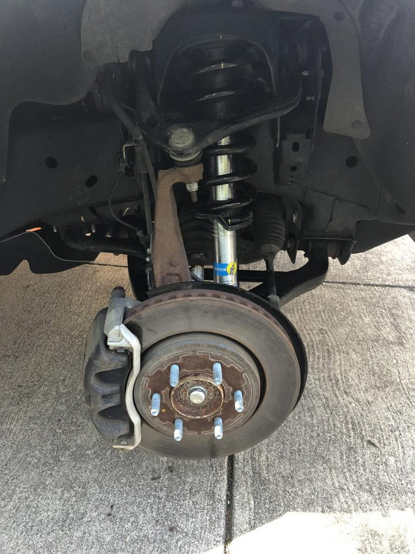

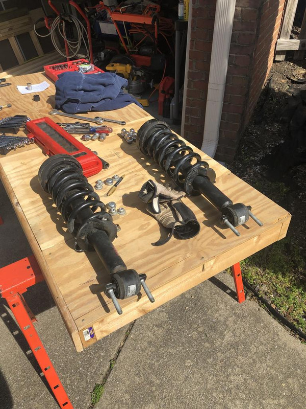

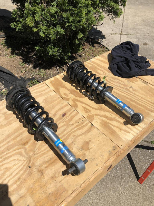

So doing the job on jack stands made it much more difficult having the fronts and rears off at the same time made it exceedingly difficult! I had not planned on that but before I went and rented a spring compressor I asked the neighbor if he had one (he owns an auto shop) He said not at the house but the shop has a wall mounted one. Run the coilovers down there and I’ll tell them to swap them out for you. Huge plus for me as the springperches are a gigantic pain to get off so I did not have to bother.
Everything came out easy. Getting back in was a chore but got done.
I am very happy with how it turned out. Only one minor issue. Bilstein does not make front struts for the Expedition though the strut is shared with the F150. The strut is spec’d To the F150 and spring. Folks have used the 4600 in the front with a spacer with great results. I figured I would give the 5100 a try since it is a adjustable leveling strut and skip the spacer.
The Bilstein top adjustement is a lift of 2”
Well it would seem that when mated with the Expedition spring you get 4” of lift. While under most driving this is not a big deal I found that large bumps really over extended things.
So I will he taking off the fronts and dropping the adjustment down 2 notches hopefully taking me to the desired 2” lift.
Kind of sucks but doing the job once already it won’t take too long 2.5 hours would be my guess.
