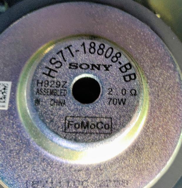

Your speakers should be marked what Independence they are. I just opened my trunk and snapped this. Tried to count the speakers, lost count around 11-12. Yours are all likely part of an infotainment system. God knows where and how many amps/crossovers there are. Best bet is find better speakers and replace stock. Not sure if you can just pop in 3in1s with built in crossovers and be done with it.

Skins2881 is correct on the ohms issue.
I'd bet most of, if not all your Avalon speakers are 2 and/or 6 ohm.
My stock door speakers were 2 ohm, the dash side speakers were 6 ohm, and the center dash speaker was a dual coil 8 ohm.

If the stock speaks are one or two ohm, just be cognizant of how loud they can be driven without being ruined.
