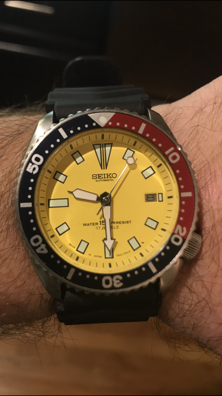

Anyway, long story short my luck with beautiful yellow dial Seiko mod divers (4205-1055 midsize & 7002) has been bad. My 4205 ran fast, it needed work prior to me ....ahem using bad internet advice and “tapping” it a bit to briskly to see if it wouldn’t run so fast (already demagnetized it) and I knocked off the second hand.
The 7002 runs fine but if I set it down it does not keep time for too long. It will typically die within 8-15 hours of being set down.
It’s a neat looking watch. I am wondering how hard it would be to put in a newer movement (7S26 or 4R36 or even a recently overhauled movement?

That's an early 7002. If it hasn't been serviced since it rolled out of the factory-- not unusual-- a simple clean/lubricate/adjust visit to a watchmaker might make it good as new. I wouldn't consider "major surgery" before that.

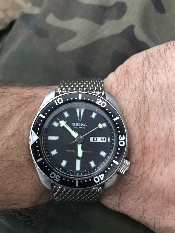

I love these Seiko Divers. I would like to be able to mod them and maintain them myself. Some of these old watches keep surprisingly good time.
My daily 6309.

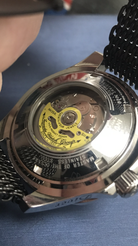

Yeah. The NH35A is a nice movement for the money. When fully charged it is very accurate. I have two Invicta divers with NH35A movements, both have been surprisingly good..
This one is quite strong. I accidentally dropped it on a concrete floor Eek. It did not sustain any damage that I could notice and kept on ticking. Still keeps great time.
