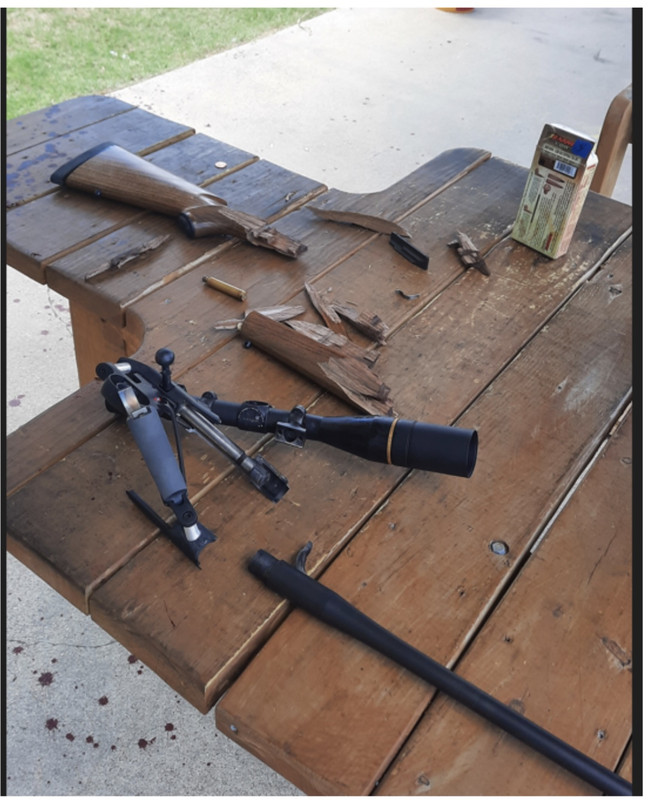

Not being much of a rifle guy, I’m wondering what round would have fit in the chamber, that would be so overpowered, that it would cause that kind of damage?

I could see it happening with two different caliber bullets, with both cartridges using the same parent case.
Jam the larger caliber in, causing severe bullet setback with no possible escape.
But I would think you would feel that in the increased amount of resistance in closing the bolt.

How about a short cased cartridge in a long case receiver. Say 308 Win. in a 7mm Rem Mag?
The bloods splatters on the concrete shooting station really drive the diligence point home for me.

Yep. Doesn’t have to be a more powerful round than what it was chambered for.

Once I loaded a 308 in a 270 Ruger 77. The 308 was hand loaded with a round nose 180gr seated out to match my 308 chamber. The 270 fired & the bolt was frozen shut. After I got the bolt open I had a gunsmith check the chamber & all was OK. I never again had more than one caliber ammo on my bench.

That’s my club. No mention of the caliber goof.
Dances With
Tornados
There’s only 1 box of ammo on the table and I can’t make out the box end details.
Same with the empty shell case, I don’t recognize what it might be.
I’m wondering if it might have been a squib, despite the wrong caliber sentence.
This is correct. Just has to be too big for the chamber or a tad too long for the chamber, things like that.
Looks to be a box of Barnes. Can’t make out anything other than that

What rifle is that? Trigger guard floor plate assembly appears to have an integral cover for the trigger mechanism.

What rifle is WAS that?
FIFY, BTW, shooter is lucky to have lived.

Knew a guy, and present, when he loaded a 308 round into an 03-A3 (30-06) and fired the round. He noticed when extracting the round and finding it was now a straight case.
It looks like a Remington 700 to me judging by the bolt and stock.

Looks like he was bleeding heavily. Look at the size of the drops.
That had to be nasty. Hope the range or someone close by had a med kit.
