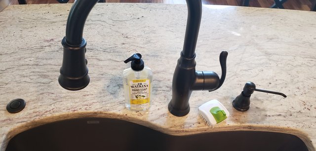

I just did a remodel and used a wireless remote switch.
We did an Island and my wife was adamant she did not want a hole in our Quartzite top.
A wall switch was out because it is in an island.
So I had two choices,
Put a switch mounted above the cabinet door opening below the sink. I have done that in the past or a remote switch.
We went with a remote switch.
https://www.amazon.com/Didikit...id=1595252172&sr=8-6
It plugs into the outlet below the sink where the disposal would plug in and the disposal plugs into that.
We have had it about a 8 months without any problems.

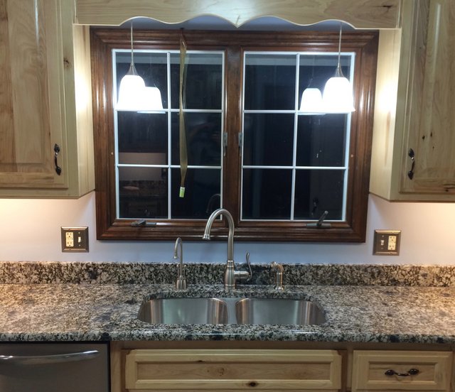

Air switches are cheap and dependable enough, exact same thing as used in Jacuzzi, hot tubs etc for decades for safety. Isolates you from any possible electrical contact in a wet location, however, I prefer and have almost always used a wall switch in the backsplash. There is another option... but it sucks IMO. That is a batch fed disposal... if they still make them. The switch is built into the disposal's drain plug and it will only run when you insert the plug and twist it to the on position, I have put in a couple of those.
At the request of the customer I have had to put a switch in the front of the base cabinet, despite my advise against it, a couple times. They think it will be really handy, it is, too handy. It is easy to accidentally rub against it and turn it on while working at the sink. Also have seen several put inside the under sink cabinet so you have to open the door to get to it... who the heck thinks that is good idea other than a lazy installer avoiding fishing a wire in the wall and cutting the switch into the backsplash.
Here is a pic of my setup as I did when remodeling. Disposal in the left side of the double sink... with its switch to the left of the sink. Switch on the right is for the pendent lights over the sink.
