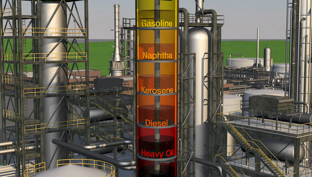

Crude oil goes into the fractional distillation column at the refinery, and several intermediate products and semi-finished products come out. This lighter stuff condenses and comes out on higher levels and the heavy stuff condenses and comes out on lower levels.
Kerosene comes out a little higher on the disty column than diesel. It has more light ends and lacks diesel's lubricating properties. Nearly all of the kerosene in the US is cleaned up and made into jet fuel. By cleaned up, I mean impurities like water but not sulfur (jet-A is high sulfur).
Some of the gasoline (we call it mogas) comes off the disty column higher than kerosene. I had to say some of the gasoline because it is much more complex as refineries are trying to maximize its production. We're sending heavy oils to be cracked (FCC or hydro) to be converted to gasoline, and we're sending lighter liquids and gases to the reformer to be rearranged into gasoline. Then its sent through units to treat and blend.
Avgas comes out of the gasoline processes, but has a higher octane AND has tetraethyl lead (awesome lubricant). Regulators are trying to phase out the lead, but every specification related to aviation moves exponentially slower than a snail (i.e. 50 year old standards are the norm).
You are correct that diesel is measured in cetane number and gasoline is measured in octane. Octane and Cetane are only useful numbers for compression engines. Turbines don't give a damn about fuel's compression ignition values so there is no cetane standard. This poses a problem for people who attempt to run Jet-A and even JP-8 in diesel motors as they can get low cetane fuel which will run poorly. As mentioned previously, jet fuel has sulfur in it and all modern diesels have been optimized to run on ultra low sulfur diesel so it'll cause additional engine wear on diesel motors.
Flash point is the best measure of the explosion you mentioned. Here are the flashpoints and classification:
  • Diesel #2: 126F (flammable)
  • Jet A: 100F (flammable)
  • Gasoline: -45F (combustible)
