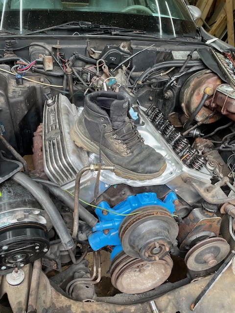

Any reason you didn't just pull the short block out of the frame at that point and do this on an engine stand? I was primarily a Pontiac guy during this time frame, though I helped out a LOT of friends w/ Small Block & Big Block Chevys that needed a solid wrench, but if my memory serves me correctly, you were one bolt on the remaining motor mount, three bolts on the Torque Converter and six bolts away from unbolting the engine from the trans, and yanking it outta there!
Why not just do that work on an engine stand, reassemble the engine and drop the whole thing in between the frame rails once you had it all back together? Your back would certainly appreciate doing it that way...I know mine would. Wink
Because there's still an engine on the engine stand AND an engine on the hoist for the second time. It was mentioned in the last thread.

Boot for reference.

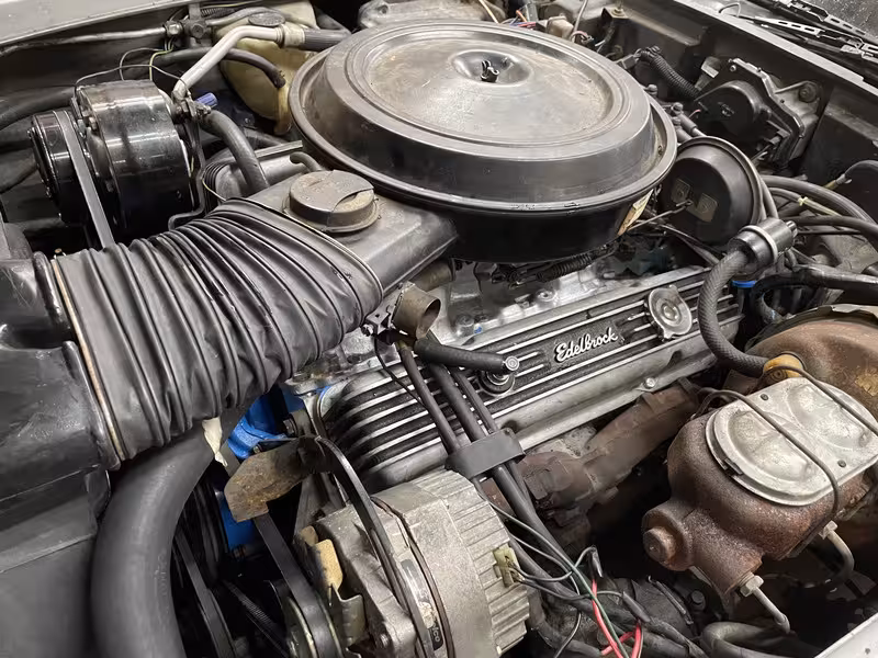

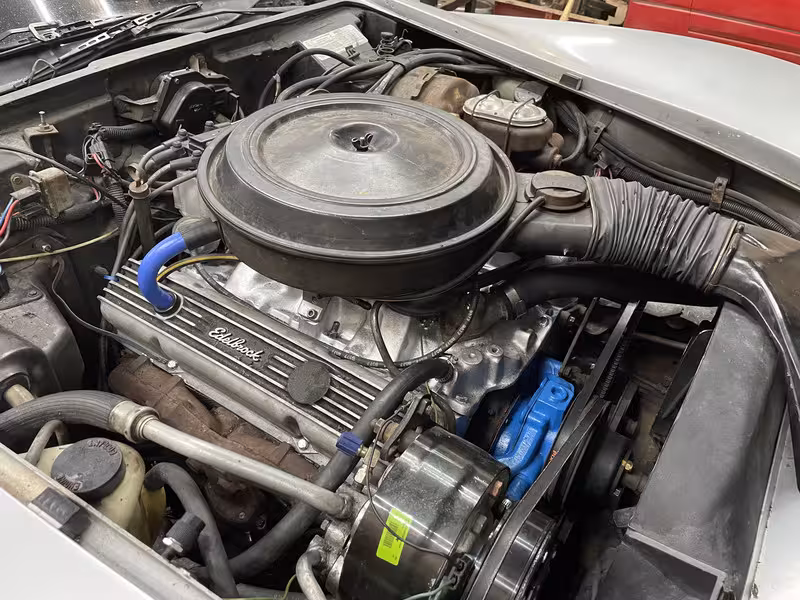

OK here's what it looks like all put together.
It's ummm, throaty now!

Is there a carburetor under that air cleaner or did you go with one of those EFI type units?
Posts: 5435 | Location: Pottstown, PA | Registered: April 26, 2002Reply With QuoteReport This Post
Shaman
Picture of ScreamingCockatoo
It's the original quadrajet.
I had to retune it for the camshaft and top-end flow.
That intake makes the stock aircleaner sit higher and it BARELY fits under the hood.
