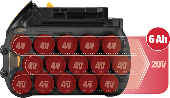

From DeWalt's own promotional images:
A DeWalt FlexVolt battery in 20V mode:
A DeWalt FlexVolt battery in 60V mode:
Notice how in both cases, all the cells are in use? And how when one number gets bigger, the other one gets smaller?
The 60V mode DOES NOT INCREASE the power capacity. The 20V mode DOES NOT DECREASE the power capacity.

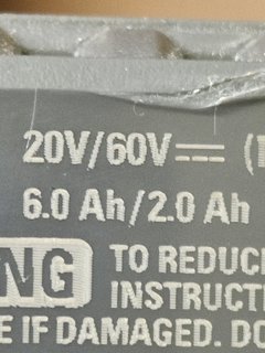

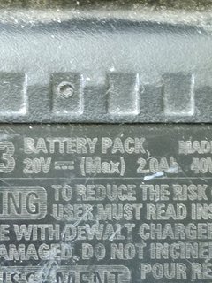

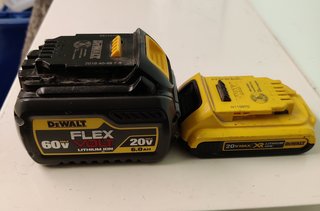

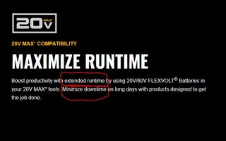

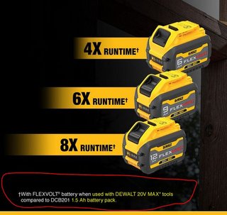

You can use all the bolding and capital letters you want. It's not going to change my mind. 12Ah is 3 times as many as 4Ah and will cut ~3x as many pieces of wood. So if you are using 20v @4Ah batteries you will not be as happy as 20v @12Ah. I am a Master Electrician and have studied electrical theory as well as work with batteries at my job.
My batteries are a little older but the math is still the same. 2Ah x 20v = 40Wh --- 6Ah x 20v = 120Wh. A watt is a measurement of power or work that is able to be done. I know the cells are actually 3.6 or 3.7v each, but I didn't feel like doing the math.
It's marked right on the back of the battery packs.
You can actually see a physical size difference between the two packs. They also weigh different, that is due to the number of cells contained within.
The other link you provided clearly shows in the picture 18-20V/12Ah battery packs if you put 20V/4Ah batteries in those same saws they cut approximately 1/3 less wood. Therefore you will need multiple battery packs for anything involving lots of cuts. I was not talking about the brand difference, I am referring to the physical battery size and power output.
