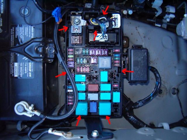

It's difficult to see, but looking closely with a flashlight and a magnifier, it does look like that alternator fuse is blown.
I guess I could try what's shown in the video.
If that fuse is blown, would it account for the vehicle not coming out of park? The alternator is in the circuit path for what?
It's the main path through the entire electrical circuit.

These larger fuses like #45 here: https://www.startmycar.com/toy...ma/info/fusebox/2007
Are these supposed to be user replaceable? I can see that the ABS fuse is blown. I tried pulling on it but naturally want to be careful. Do I just need to pull harder?
If I can change out the alternator fuse myself, and get this thing going again, that would be great. In my younger days, I did a bit of mechanic work on my cars, but never would I say I really knew what I was doing.

Some of these modern fuses are held in pretty tight by their connectors to ensure they don't vibrate loose and resist corrosion through a light connection.
Pull harder, you'll know if it's bolted in from the sides.
I'm wagering it's not.

My quess is the starter relay may have burned up.
You might be able to swap the horn relay with the starter relay if they are same.
Posts: 1970 | Location: New Mexico | Registered: March 21, 2017Reply With QuoteReport This Post
If so, it would be in addition to the alternator fuse, because that fuse is blown for sure.
The fuse he mentioned in the passenger compartment- I checked it and it's OK. AM1 and AM2 also appear to be OK.
Posts: 115043 | Registered: January 20, 2000Reply With QuoteReport This Post
A vehicle with a dead battery won't come out of park so a break in the circuit could produce that result. There will be a shift lock override button somewhere near the shifter that will allow you to shift without power, usually so you can get into neutral to push.

I looked at your relay part number and you don't have one to swap around.
I guess I should assume that this relay is burnt and buy one along with the alternator fuse and the ABS fuse.
What's that relay part number?
I found on Amazon what I thought was the correct alternator fuse. 120 amp, looks like the right part but the Amazon parts guide say that it won't fit.
I suppose my local Auto-Zone can sort out the part number for me.

Apparently, there are clips around the fuse box housing that will release the fuse block allowing you to lift it up high enough to remove the bolts for the alternator fuse:
I'm guessing the one nut left of the fuse (when standing in front of the truck) would also have to be removed.

Toyota starter relay part
#28300-0A011
I think it's made by denso.
Pricey from Toyota of course.
https://toyota.oempartsonline....lectrical-components
https://toyota.oempartsonline....U9NC0wbC12Ni1nYXM%3D

Hi Para. I have a first gen 2000 Tacoma 2.7L 5 speed. I accidentally reversed the cables when jumping it a couple of years ago and had the same symptoms. I fried the main fusible link fuse and it was bolted in and difficult to change. It looked like this (below). I dont know what year your Tacoma is, but you might Google "how to change fusible link" in whatever year and engine truck you have. I had to remove the fusebox to get to the bolt that was anchoring in the FL main fuse.
https://www.ebay.com/itm/18672...ghnht_ewCbbXvt5cBykg
https://parts.lakelandtoyota.c...&feedLabel=cvb_parts
Posts: 3300 | Registered: August 19, 2001Reply With QuoteReport This Post

I'm quite confident this is the problem also.
If I wasn't so busy during the week, I'd make a roadtrip out there and do it myself.

This is the part we've been referring to as the alternator fuse, yes?
This video: https://www.youtube.com/watch?v=aUnXxWYtf2A
shows what I have. The part of the video where he has to crack the case- I think this wrench is the answer: https://www.amazon.com/gp/prod...A33L0O1J6GMEUP&psc=1
The other bolt looks like you can get a ratchet in there.
I don't think I'll have to remove the fusebox altogether. As a matter of fact, I'm not sure why the guy in that video loosened the mounting bolts for it. Maybe I'm missing something.

If you can hang on until Saturday, we can come replace the fuse and diagnose the truck.
