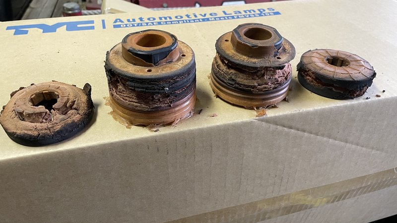

While they were all in some state of deterioration, these were the two worst:
The short one on the left is supposed to look like the short one on the right. They are pairs, one short and one long per location.
My post wasn’t meant to be a complaint or call for a recall. It was really meant to be a hey, if you own a Super Duty, take 3 minutes and check your bushings out. I hope they don’t look like mine did. Smile
Thx for the pics. It really shows what a weak link those are in support and comfort of the vehicle. Time to do some more reading and maybe find some vids that address this issue as well.
