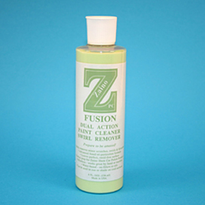

I would recommend a car polish, not a polishing compound, that is too abrasive.
Zaino makes a polish just for the purpose of taking those type spots out. It is not however, an easy task and an orbital polisher is pretty much required.
http://www.zainostore.com/mm5/images2/Z-PC.jpg
Do what you can with this and then wax it. Set it out in the hot sun. Sometimes etchings , like from bird shit, will self correct in the sun.
