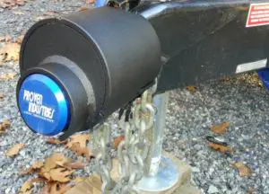

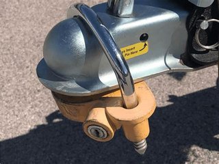

trapper189
Originally posted by Aeteocles:
or an angle grinder.
Like a hot knife through butter. The advent of battery powered tools that are close if not on par to their corded equivalents has made thievery much easier.
I’m thankful for the YouTube videos as they show real world vulnerabilities of systems that give people a false sense of security. Take these two trailer locks for example:
Which one will slow a thief down better?
