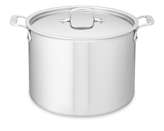

A stainless stock pot or serving line (cafeteria) pan would be fine to contain a fire and shrapnel. And dont buy Chinese batteries to begin with. I saw somewhere that most of the "Fire" brand 18650's are just recycled old laptop batteries once you peel off the label.
