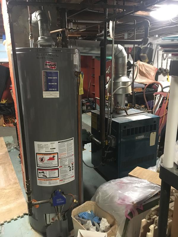

The old boiler and water heater, about 200,000btu total, natural draft combustion:

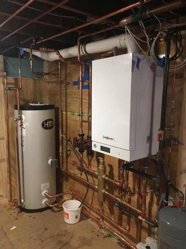

The new boiler, with a loop through a storage tank for hot water, 120,000btu, sealed combustion condensing boiler with outdoor reset:

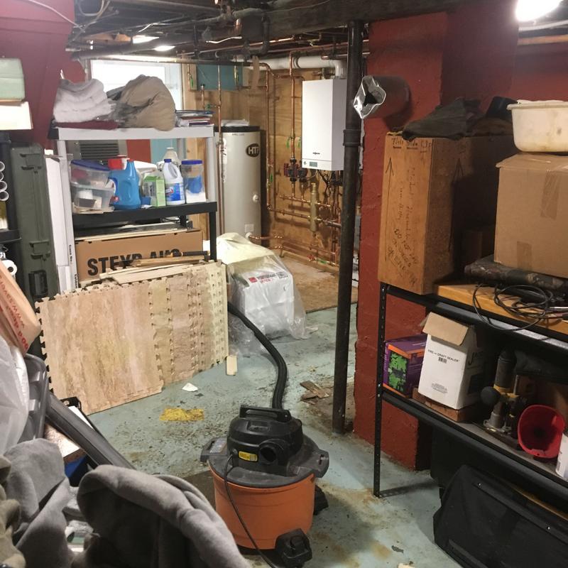

A look across the basement where the old boiler and water heater were. Chimney is texture painted red, and will be removed.
I've got some roofing to do, the three first floor sheds, and I'll be getting a 60 foot boom lift to do the chimney, I hate doing them off of ladders.
