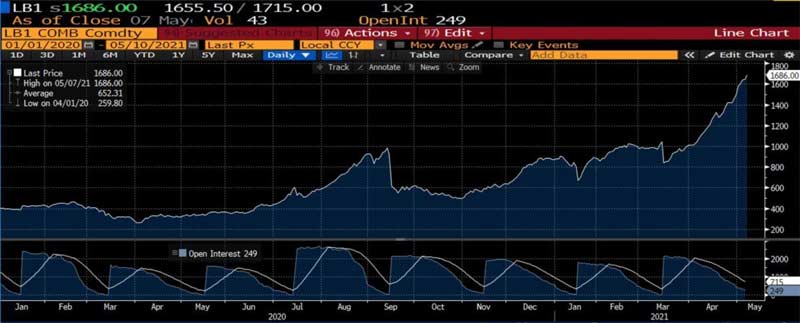

Just got an article from the American Institute of Economic Research on the lumber market craziness: link to full article: "The Lumber Market Delerium"
Over 75 percent of homeowners surveyed by Porch.com in July 2020 had completed a home improvement project since the beginning of the pandemic. Would-be craftsmen who have waited until now to begin renovations may be out of luck, however––over the past year, the price of lumber has skyrocketed, and home project expenses have risen with them.
From a price of $259.80 per thousand board-feet (the standard unit of lumber trading) on 1 April 2020, on Friday 7 May 2021, the price of lumber had risen to $1,686 per thousand board-feet as the DIY boom coincided with dire challenges to the lumber industry, including increased home building, mill closures, and staffing shortages.
Lumber prices per thousand board-feet (2020–Present)
Again, I can't speak to steel building costs, but this seems a very expensive time to start any wood-based projects that have flexible timeframes.
