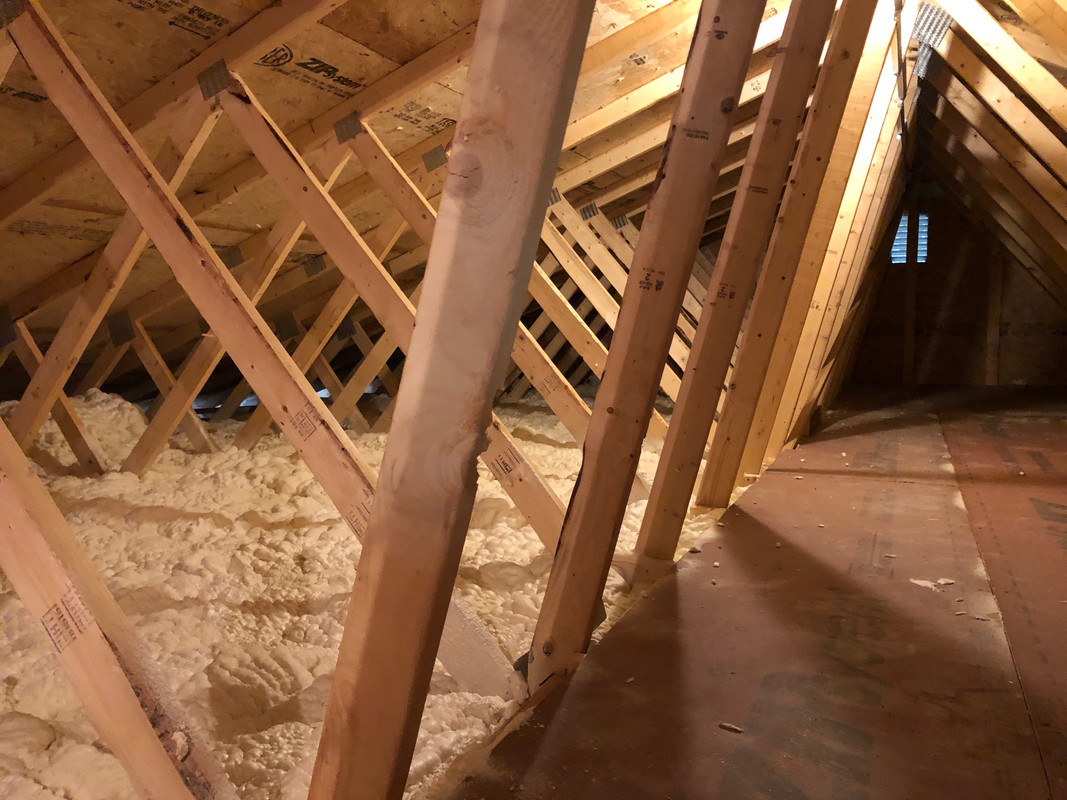

That's very similar to what I did to my house. You can use the area that forms a triangle in the center of the truss. I screwed 2 x 4's about 12" or so off the floor (to clear insulation) and laid down 3/4" plywood. You have to crawl on your hands and knees, but it works.
Yep. I plan on building maybe a dozen narrow, long shelves going back between the trusses.

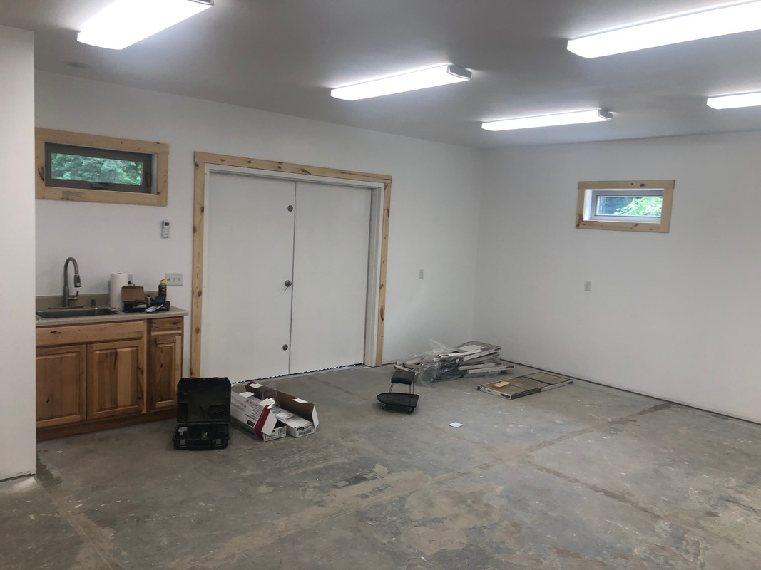

I'm surprised to not see a garage door entrance. The double pedestrian doors will be sufficient?
Posts: 42260 | Location: SC Lowcountry/Cape Cod | Registered: November 22, 2002Reply With QuoteReport This Post
Picture of ridewv

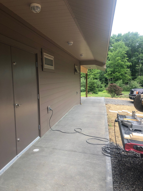

I think it'll work alright it's a commercial double door 7' wide x 7' high so a side by side or even a compact tractor will fit. I wanted the door to seal very well and be rodent proof, the damn mice chew through the bottom seal at the corners on my garage door.

Finished!

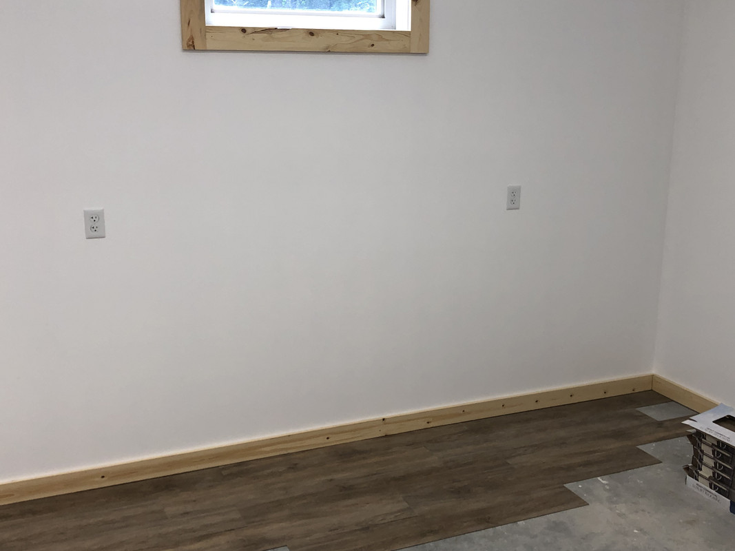

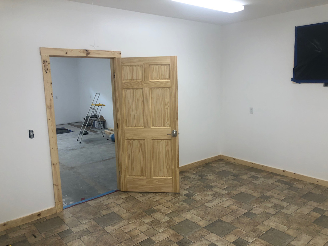

Contractor built up the grade, raked and planted grass (which is already coming up thanks to all the damn rain!) also finished up some little things inside like running the base and a few electrical items so they're done. I Put down some laminate flooring in the wood shop room yesterday, now I just need to get the LVP installed in the rest of the building, then move stuff in and start using it. Big Grin

I looked into Swisstrax as well as other "garage flooring" but I ended up going with LVP for a couple reasons. One I didn't want any flooring that was solid color as it shows dirt, dust, stains, scratches, etc. too much. It needs to be textured for non-slip, stand up to tires, side stand legs, work benches, etc. I found this LVT with a 27 mil wear layer for $2.30 per sq. ft. including adhesive. The laminate I already had.
Those planks are just laying there not glued, I wish they were a little lighter in color but I think they'll be functional.
