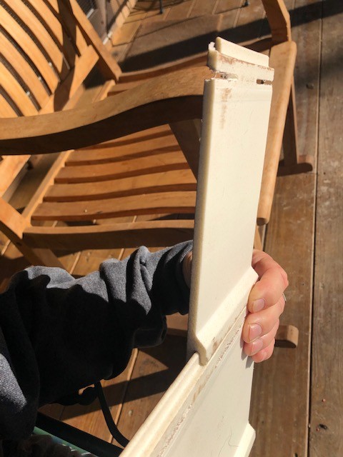

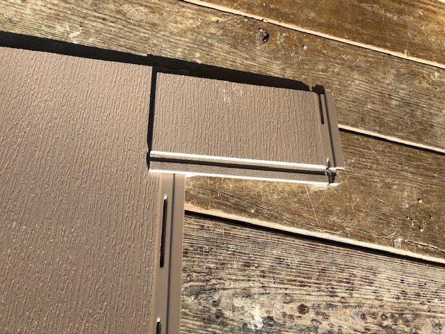

I really like this siding it's Celect by Royal and I first saw it on the house they were building previous to starting my shop. I thought it was Hard Plank because that's about what it looks like but it's some type of rigid plastic with each piece (both sides and ends) interlocking to the next, sort of like click together laminate flooring.

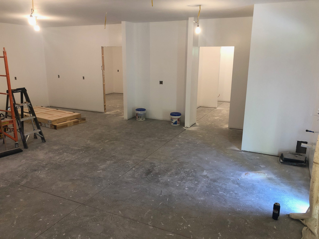

Not much has happened outside as we're *still* waiting on the windows and door..... supposedly they'll be here Wednesday. Inside all the wiring is roughed in, ceiling drywall hung, insulation sprayed, and working on wall drywall now. I never requested it but they're using 5/8" drywall everywhere.

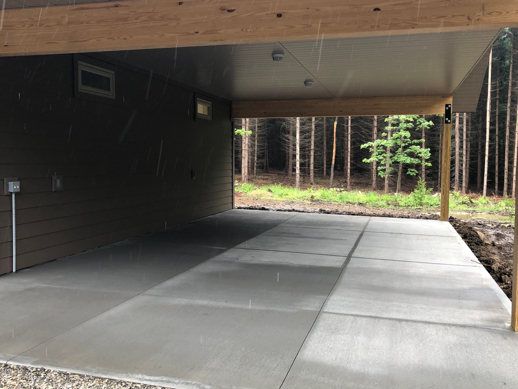

It's all but finished. The guys did a pretty nice job on drywall and paint, and poured the exterior concrete Monday. Remaining for me is to tidy up the outside and plant grass, install the flooring which is acclimating now, paint the front door, seal the concrete, and the electrician has a couple things to finish. Then start moving stuff in. One thing we did which I didn't plan on is to utilize a section of the unfinished attic for storage by building up some of the joists above the insulation and laying plywood to walk on along with a pull down stairway for access. The space is unconditioned but will be ok for storing boxes, exhausts, etc.

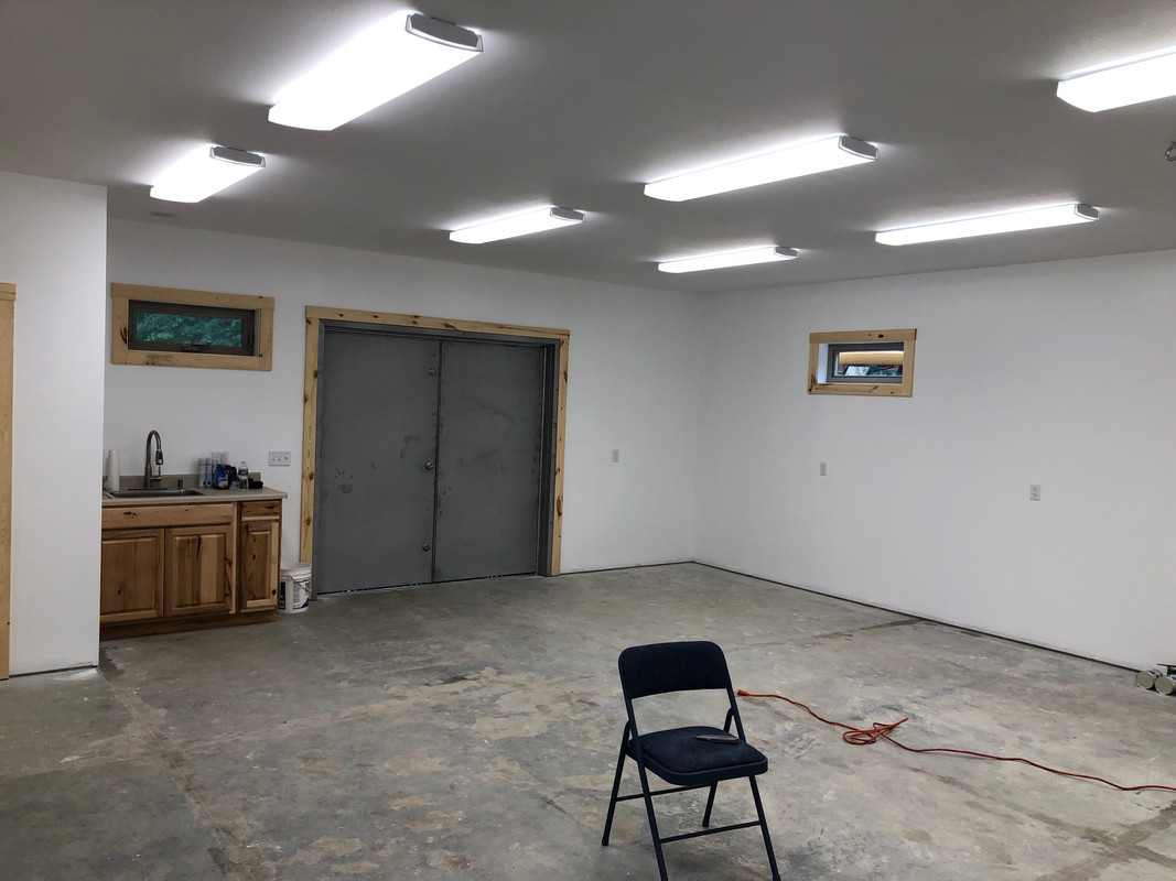

Not really fancy but commercial 27 mil wear layer LVT for the large area and small room, and Faus laminate flooring (which I already had) in the 14' x 16' room. All material has been acclimating for a week, I just checked the slab for moisture and it's dry as a bone.
