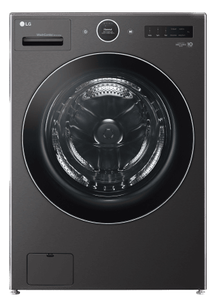

Easy, "All-in-One" washer/dryer. I LOVE mine. Needs water + drain +120v (No 220, no vent) takes up only half the space. Basically, it has a dehumidifier to dry the clothes. Bonus it is SUPER efficient (My smart meter says I only use <$4 worth of electricity per month for the washer) and you will never have to or forget to move the clothes from the washer to the dryer.
Possible negatives: a cycle takes 4-5 hours, (Irrelevant in my case) and complexity I guess in the event of a repair or replacement.
I got a ~$1,700 LG in late '23. There is also a larger GE version might be nicer IDK for ~$2.2k
LG all-in-one
Posts: 615 | Location: Fort Couch (VA) | Registered: December 16, 2012Reply With QuoteReport This Post
