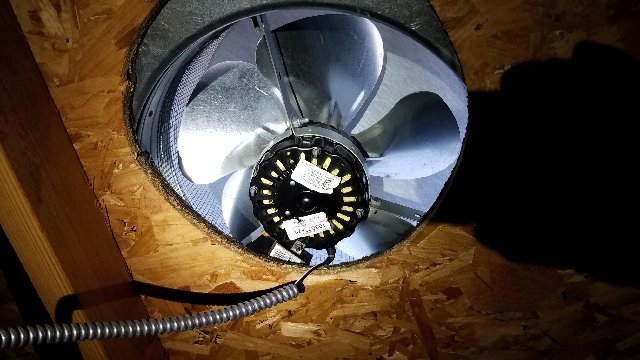

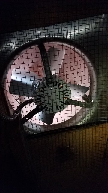

Post some pics so I can make sure it's possible to DIY.
These are your three basic setups (these all have problems otherwise I wouldn't take pics, but just so you know what you're looking at):
Single sheet metal screw:
Nut and Bolt:
Lamanco brand, needs either exact replacement or an electrician who knows what pieces and parts to Frankenstein together.
Nutone Brand :
No pics but will look completely different than above even if sticker has worn/fallen off. If nutone, I suggest having roofer replace whole unit. Usually they won't make electrical connections or disconnections.
I have changed ~300 of these motors. I can usually do it in 30 min or less, novice time <90 min.

No repairing it likely, if has a capacitor like is barely visible in my second picture, those can fail and be replaced. At 23 years it's lived a full life and is time to be replaced.

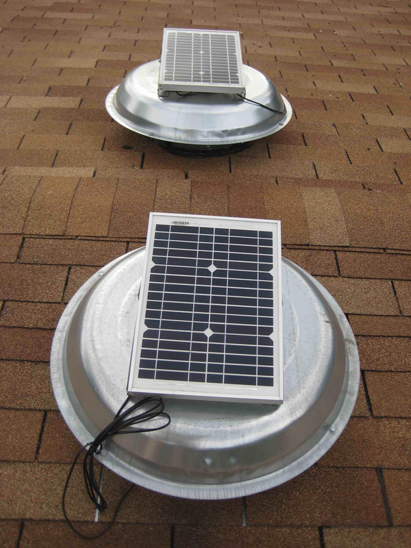

I needed attic ventilation in a farm garage where we have the power turned off occasionally.
These solar roof vent fans were simple to install and have done a great job. Obviously this would be for when 24 hour fan service isn't necessary.

A new fan with the solar option would be nice if it's on a southern facing roof without any shade from trees.
It would be eco-logically sound.
