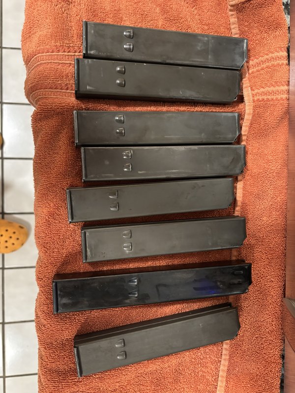

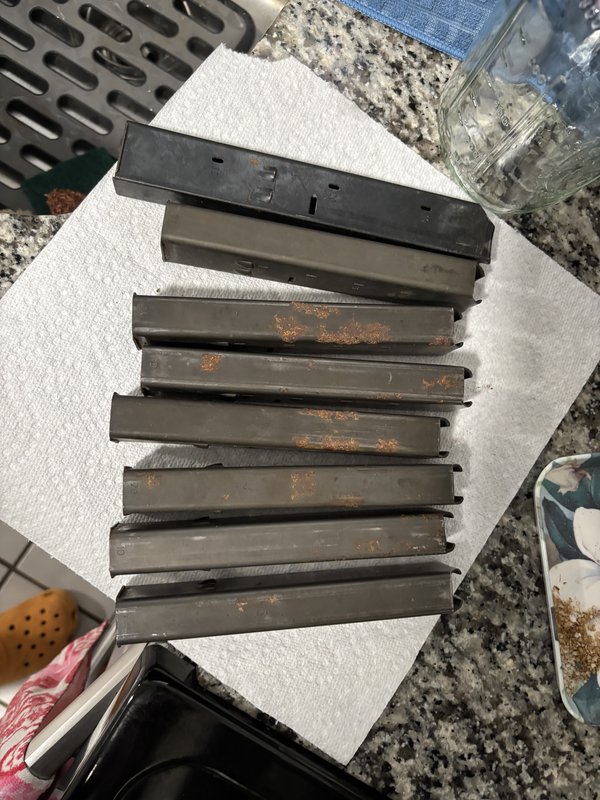

Nothing crazy, had some Uzi mags out of the bunch that like most of my dad’s stuff hadn’t been taken care of.
Wire wheeled, washed in hot soapy water, cleaned, baked dry, then hit some little spots again with the wire wheel. Finished with a good wiping with a silicone rag. I’ll check em weekly then monthly to see if it was worth the trouble or if I should just toss em.
Was also able to save a fully rusted Ruger factory 10 round mini-14 mag. It turned out great.
Before
After

Some of the handguns I carry have blued steel magazines. I'll occasionally give them a coat of automotive paste wax. Let it dry and then buff with a soft cloth. It seems to help protect them from perspiration and makes cleaning them easier.

Did you eyeball the interior as well?

You should parkerize them again to cover the bare steel
