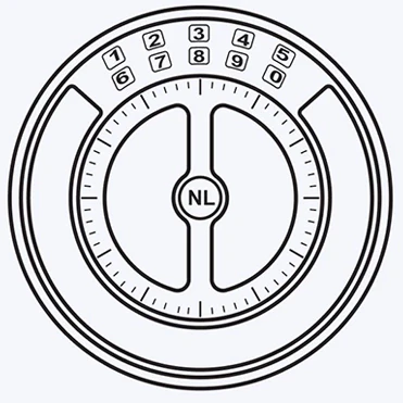

When we bought our house, it came with a Canon Safe as part of the deal.
I have the code the prior owner set, and it works, but I'm wanting to set my own code on it.
I do not have the manual for it, and trying to access canonsafe.com results in a redirect to Google.com Confused
Also, how long should I expect the battery life of the 9v battery to be? The prior owner said (via my RE agent) he kept the battery out of it to avoid the battery dying.
Thirdly, any safe 'accessories' to recommend? It's in our [large] laundry room, and adjacent to the [room converted] garage, but the humidity level in there [laundry room] stays pretty low with the size of the room.
Probably still worth adding in some humidity control in the safe.

safe & sound
Picture of a1abdj
Does the lock have a manufacturer label or any other lettering that would help identify what it is?
If not, could you post a photo (or if you don't want to post it, you can e-mail it to me).
I wouldn't worry about the battery remaining in the lock. If the lock is operating properly there's no real drain and should last many years with regular use.
www.zykansafe.com
Posts: 16310 | Location: St. Charles, MO, USA | Registered: September 22, 2003Reply With QuoteReport This Post

I ordered same safe with combo lock. Also use a key if desired.
It appears they dont carry that model anymore. Follow this Link to id your lock for obsolete manuals. Hope that helps.

No identifying marks/labels that I can find on the unit (dial or safe in general).
It's built into a cabinet, so I can only see the door and the interior of the safe.
Posts: 18680 | Location: Spring, TX | Registered: July 11, 2011Reply With QuoteReport This Post

Securams are six zeros to enter program mode, your existing 6 digit combination, your new 6 digit combination, and then repeat your new 6 digit combination.
Nothing in between or after. Say your current combination is 1-2-3-4-5-6, and you want your combination to be 8-6-7-5-3-0:
0-0-0-0-0-0
then
1-2-3-4-5-6
then
8-6-7-5-3-0
then
8-6-7-5-3-0
It will make a double beep after each entry. Do it with the door open and check it after, but most of the UL locks will not change unless you did everything correctly.
www.zykansafe.com

I've got a Cannon Executive Series safe and here's a photo of the page in the User's Manual for programming the lock:
