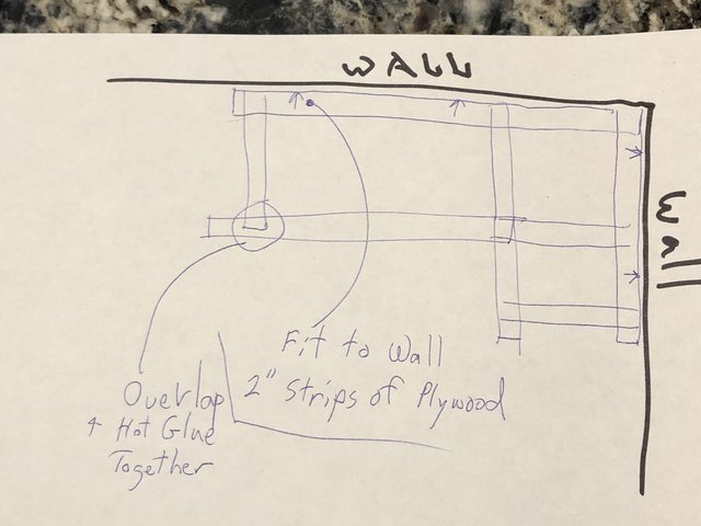

The professional Granite installers I have worked with make a template out of 1/4 strips of plywood skeleton glued up that they fit to the wall. When they get a perfect fit with the cheap sacrificial plywood they then transfer/trace it onto the actual top to cut.
Or you take the easy way out and add a backsplash to cover any gaps.

exactly how I would do it the thin strips are easy to scrip then just transfer it over and make any minor adjustments. Cabinetmaker for 35 years.

Using XLT"s suggestion will show how far the corner is out of square either opened up or closed in faster when layed on top of the actual counter top.. .. When making the framework of the pattern support the counter top near position which will support the frame work while you use 1/4 plywood 3 inch wide strips and where strips cross each other use a hot glue gun or contact glue that will hold the frame from moving. Then take a compass or pencil layed flat vertically and trace the wall shape. Use a jig saw or belt sander to shape the form that matches the wall the transfer this pattern to the actual counter top...... Or support the top in position and trace wall with compass or flat pencil working longer edge first getting a fit then the short edge. If the gap is greater than a pencil then use a compass set for the greatest gap that when trimed there should be a snug fit. If space is not that bad then possibly install a back splash You did not say if one or both ends of top will be open or up against a wall.. If so then the plywood frame might be easier and or faster if you do not have a extra set of hands to help hold things. .. Been there/done that/ got several t-shits. 35 yrs cabinet maker retired. .............................. drill sgt.
