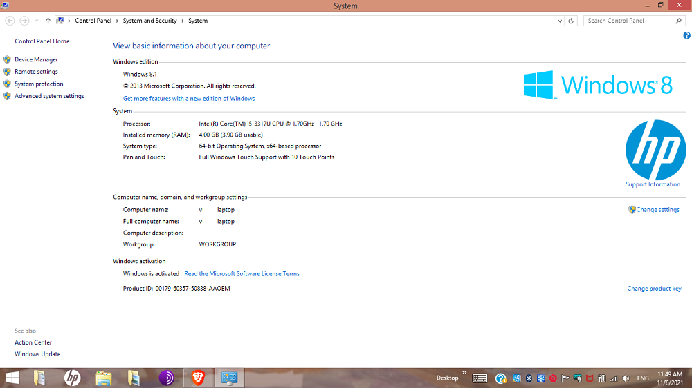

Windows 8.1 and looks like I still have plenty of memory. I actually use the external mouse on this the most. It's more natural to me. And, it's working just fine, in addition to the touch screen. The only reason I found the touch pad wasn't working is I left the mouse somewhere a couple of days ago and tried to use the touch pad.

I agree with smschulz that Windows 8 is pretty much garbage, and I know that you can upgrade to Win10 with a bit of hoop jumping, but I would worry a little bit about running Windows 10 with only 4GB of memory. It's possible to run, but may not be a great experience, and there may be other issues (such as hardware drivers) that pop up after the upgrade.
To be honest (and of course this is very much dependent on your budget) I would probably look at a replacement at this point. I've run newer operating systems on all sorts of hardware, including Windows 10 on machines older than yours and it can work, but it can also be somewhat finicky, and I've never done this with my primary machine.

BUT, when you update to Win 10, if your machine doesn't have enough disk and/or RAM, you could be in for a surprise, as in, it won't run at all. This happened to me on a cheaply outfitted by otherwise competent laptop machine.
As old as it is, if the upgrade doesn't work, it's probably time for a new machine. Yea I hate it too. But planned obsolescence is the standard for computer based electronics.
