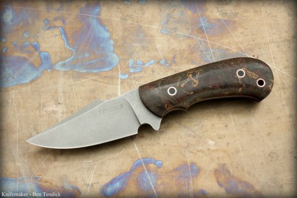

I really like the look of the Rag style, but I’ll just bet that’ll be the one that gives me fits.
Of course I’m not making knives but I have a couple that need new handles and some bottle openers as well that I want to add them to.
Anyone here make their own ?!?! Pics ?!?
*Rag style Micarta (pics from the web)
