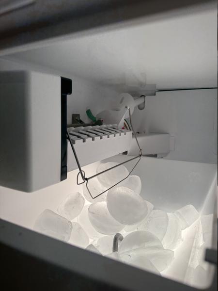

I have a 20 year old Jenn-air fridge that has served well. Until a couple of weeks ago that is- the ice maker has stopped working. It stopped abruptly without any signs of anything being amiss. About a year ago, the filler tube developed a frozen clog and needed some hair dryer work to get up and running.
This time the hair dryer trick changed nothing. Other pertinent information includes the water function still works fine. The maker seems to cycle randomly but no ice is being made. Should I do a complete defrost? Or is there some trick I can try? All suggestions are appreciated. And for those wondering why I somehow have ice, I had to get a couple of tray cube makers to get by.
Here’s a pic of the unit itself if it helps figure this out. Thanks in advance.

Ok on moduler icemaker. You can jumper from T to H on the front (remove the cover)to cycle it. Short piece of insulated wire with half inch stripped on both ends and ent into a U. Pull the wire when the reference mark on the gear gets to 12 o'clock. Bar goes up and down whand right after it drops is when the valve is energized.
Before you try that, disconnect the 1/4 linear the valve that leads up to the icemaker on the back. If you can blow through it, the line isn’t frozen. Reconnect it before cycling it. If you have line voltage at the point it powers the valve, bad valve. If not.bad mold heater or model, so replace the icemaker

I’d pretty much fallen into resignation that the ice maker was done and have been making cubes as needed. Nothing crazy, about $10 invested in a couple of regular trays and a couple of large 3” cube trays. The plan was to clean out old freezer food, secure the good stuff and an unplug and thaw cycle to clear any frozen line before moving to a replacement.
Skip to this morning. When returning from taking the hounds out at 5:30, I heard the telltale clunk of ice being ejected followed by the sound of running water. The hopper has fresh cubes on it and the maker had filled with water. It would seem that the ice maker has decided to play nice after 3 weeks of quiescence.
Nothing has been done since the initial attempts to troubleshoot. Odd to say the least but I’m not complaining. Thanks to all that offered ideas and especially to Tony for the generous offer of the solenoid which it now appears won’t be necessary.
