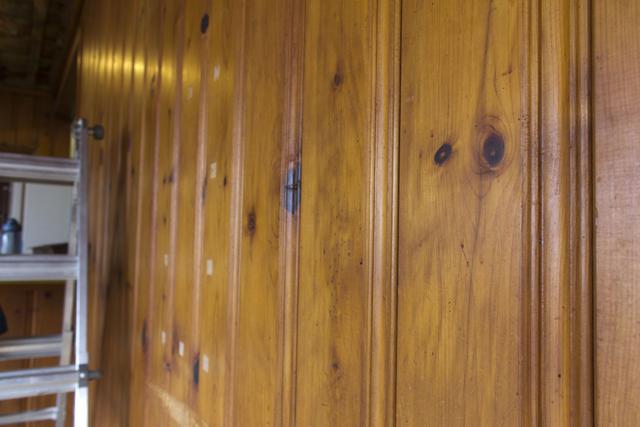

I'd like to hang a 42" plasma TV on a knotty pine paneled wall. The plasma is pretty heavy for a 42", so I need to find the studs, but am having a difficult time. My electronic studfinder doesn't work and there are no electrical boxes on the wall. Crawl space reveals nothing, and there's no room above this one and no access to the space above the ceiling. The paneling is tongue-in-roove and is vertical. Using a magnet I can find rows of nails every 6-8" in the panel joint that are horizontal, but the horizontal rows are 20" apart. Is that some sort of furring strip to mount the panneling to or it is possible the studs are horizontal?

I highly doubt that they are horizontal studs. Most likely they put in blocking between the studs since the paneling is vertical.
The studs will be 16in on center. Try measuring 16.5" from the corner and that should be the center of the first stud. The center of every other stud should be 16" from there.

He called it paneling though. If individual planks, I would throw some screws through it into the furring strips behind where the TV would be mounted and mount the TV directly to the wall. I wouldn't use an arm type mount that lets you pull the TV away from the wall thos way. For one of those I'd find the studs. I have two 42" plasmas and they are heavy.

1) If it is paneling, find a spot and gently pull the paneling off. Take a look and then nail it back in. I used to do that at my grandpa's house, a storage area was behind it.

It's probably on 1" furring strips and that is why it appears to be horizontal.

If you can remove the baseboard you may be able to find the studs

Lots methods to find the studs, as mentioned. Something else to consider is what's behind the pine wall? It may very well be on thin furring strips with a block wall behind it. The TV's that I've hung use about a 3" bolt, you may be punching through the concrete block if that is what's behind the pine.

3. Use the smallest diameter nail you can find and poke it through the wall until you find the stud. This works well with drywall, might not be so good with panel.

Assuming this is what you have is the circa 1950 - 60's, 3/4 inch thick tongue and groves planks. The horizontal bits should be blocking between the studs.
Is this what you have?

I agree with pulling the baseboard if you have one, as well as maybe drilling or nailing tiny test holes way down by the floor where no one will notice after the fact.
