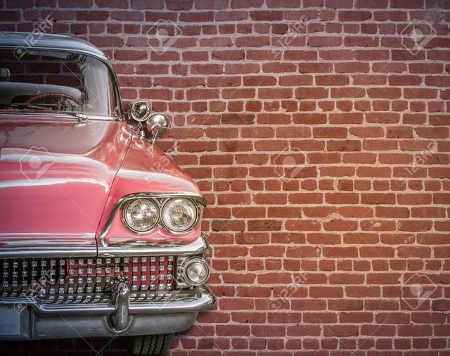

Here's a strange question. Go look outside at your bricks. If you have every seventh brick turned sideways and the wood is original, then it's very likely only furring strips secured with cut nails. Especially accurate with 50's construction.
If you mean every 7th brick in a single course is sideways, no.
If you mean every 7th course is all sideways bricks, then yes

Like this.
Posts: 21839 | Location: Loudoun County, Virginia | Registered: December 27, 2014Reply With QuoteReport This Post
Too clever by half
Like this.
Yes, except this is every 6th course sideways, mine is every 7th course sideways.
Posts: 10388 | Location: Richmond, VA | Registered: December 11, 2007Reply With QuoteReport This Post
First random pic I stole from interwebz, didn't count them. It means the brick is structural. And you have two courses of CMU tied into every seventh course of bricks. Insulation was not common when this building method was used, instead it relied on the air gaps in the CMU for insulation. Therefore they could make larger rooms with out using 2x4s and cut lumber costs.
Try your drilling test method horizontally and see if they actually run horizontal. Also use a bit that is at least 2.5" long. This will cover planking plus furring strip. You will feel a difference when it hits block vs furring strip.
If you do find that it is horizontal furring strips, there is an easy solution. Measure depth of planking + furring strips, then buy correct sized lag bolts for top set of holes on TV mount. Use four shorter lag bolts on top furring strip and use 2-4 #10 or #12 wood screws only in planking for bottom set of holes on the mount. Those screws are not nearly as important as the top holes.
