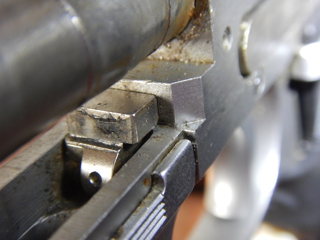

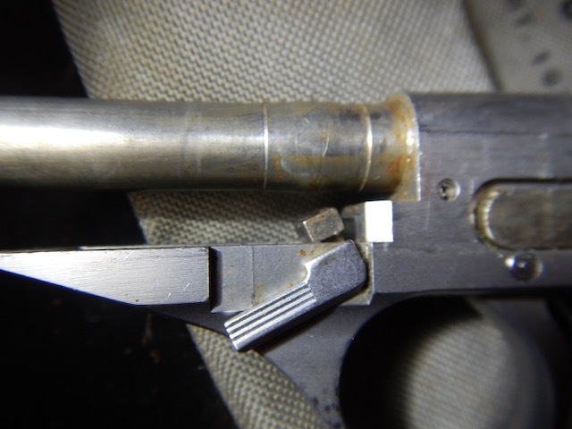

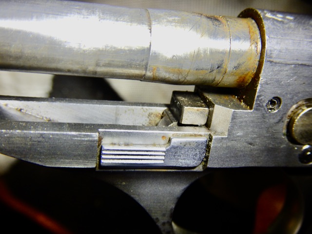

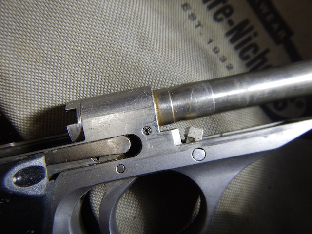

Now I don't know if this will be helpful.. but I broke down the P230 I carried for years and took some pictures which are pasted below... and because I'm not too proud I did not clean the pistol before I took these... there is no rust... all that brown is just old oil and debris...

That is a helpful set of photographs Blume . I think I got the lever about as far down as that first photo, maybe even a tad more.
I can see the dimple shown in the third photo and tried to pry it down with a tool. No movement but there is very little room to maneuver.
My plan is to see if I can get a very small broken screw extractor to grab the end of the pin and turn it that way. I've ordered a set that should be here tomorrow. In the meantime it is soaking nose down in a cup of Breakfree.
I agree that the part could be fabricated once it is in hand. I might even could tap and screw it back together or have someone weld it as others have suggested.
