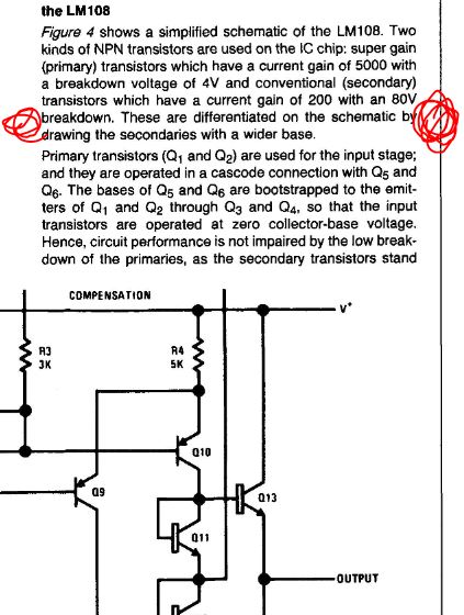

This is something I've not come across and i don't remember there being a schematic distinction between transistors. They are both NPN but one shows the base as a line and the other as a rectangle. Why the distinction?

It's the schematic for what's inside an LMx08:
http://www.mit.edu/~6.301/LM108.pdf

The answer my friend is in this book, on printed page 50, location 75 in this scan:
https://archive.org/details/Na...andbook1994/page/n75
note the lower gain (beta) transistors have the wider base rectangle. These also have a higher breakdown voltage.
