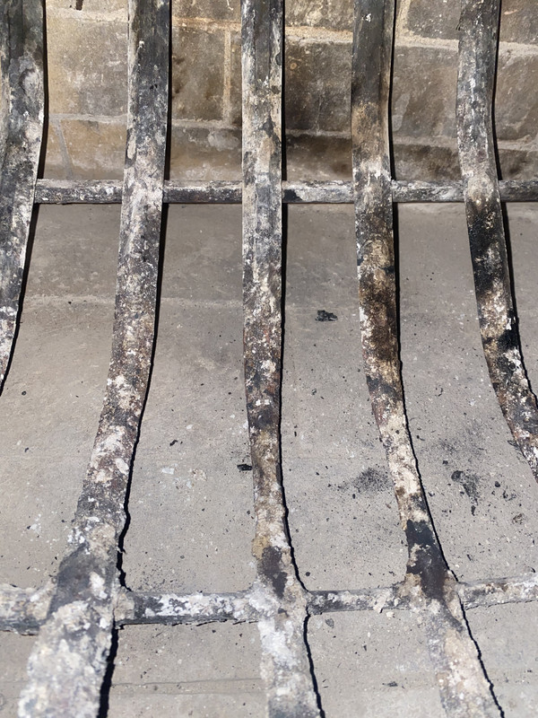

| quote: Originally posted by thumperfbc: While I knew the almond would burn hotter than a lot of other wood I didn’t realize it would burn hot enough for the very thick steel grate the bend and warp and begin “chewing” away.
The "chewing" is likely from rust. Wood ash collects and retains moisture from the air, and traps it against the metal, causing rust. |

| Why wouldn't it be? The charcoal grates on Weber grills are a thick steel that within a few seasons is warped and burned up by the intense heat of the coals.

| Yup.
I’ve always liked the grates with separate relatively heavy bars welded together, maybe because that is what I grew up using.
However, my Mom switched over to grates made out of cast iron sections that are curved (front to back), only about a quarter inch thick, and bolt together with the number of sections depending on the width of the fireplace. From recollection, the legs bolt on as well. Contrary to my expectation, these seem to hold up *much* better than the ones of welded steel bars.
I don’t know if this is because the cast iron handles the heat better than the steel, because the pattern of the grate is more like a sheet with lots of smaller holes in it so it keeps the vast majority of the coals on top of the grate rather than under it, some combination of the two, or other factors that haven’t occurred to me. It is definitely another type of grate to consider though. |

| Burning almond and oak, I seemed to get about three seasons out of the commercially available fire place grates.

| Steel exhibits degradation from burning and rusting much faster than cast iron, a heavy cast iron grate will last a long time. |

| When we had a large masonry fireplace that we built HUGE and very hot fires in, we went through a grate or two a year until I finally broke down, sought out a super heavy duty one and bit the bullet on that. We moved 3 years later and it was still hanging in there. The lesser ones would heat up enough to sag in the middle. Once down near the fireplace floor it impeded airflow. Time for an upgrade.

| Fireplace grates should be built with at least 1" thick bars. Far too many these days are not even close to that. |
| quote: Originally posted by architect: Steel exhibits degradation from burning and rusting much faster than cast iron, a heavy cast iron grate will last a long time.
True replace it with a quality cast iron grate if you can. Be aware that allowing ashes to accumulate deep enough under a grate that they touch it will (with a hot fire above) over heat the grate, almost like a forge.

| As stated above, the accumulation of ash creates a thermal insulation and the hot embers heat becomes concentrated, and the liberation of moisture and breaking down of carbon matter creates nitrogen oxides and that is acidic. And all of that munching on your grate takes it's toll. Corrosion is oxidation, and "burning" is much more rapid oxidation.
