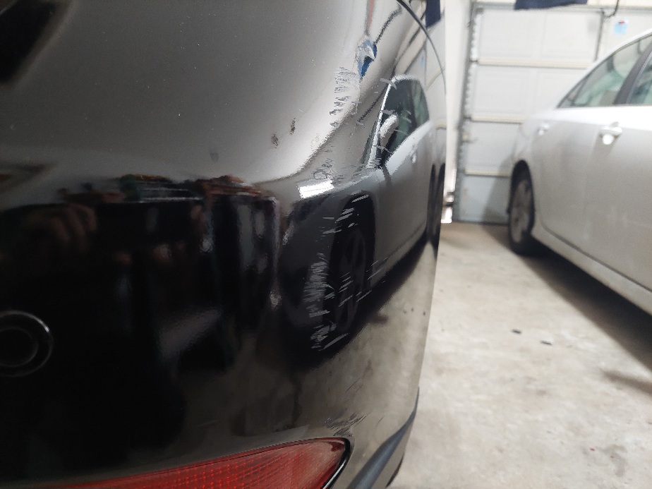

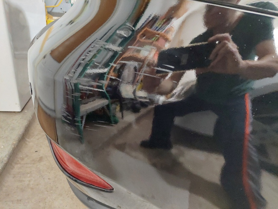

Earlier this week, I was an idiot backing up my RX350 into the parking space at HEB, managing to scratch the right corner of the bumper against the big concrete base of one of the light poles. Initially it looks real nasty with the yellow paint stuck to it. Took it to dealer for an estimate and got a quote of $1306. Took it to a local independent body shop (Santa Ana), they cleaned off the yellow paint and quoted me $893. Take a look at the pics and tell me what you think cost-wise. Thanks.
ETA: It doesn't have any big nasty dent and doesn't look so bad, now, especially with the yellow paint off. If it were cheaper, I might consider it, but at $900, I'm mulling just to leave the thing as is.

The scratch on top looks pretty deep, not sure what they use for filler on plastic bumpers, I know the paint needs some flex additive.
Between the repair time and paint cost , that price doesn't surprise me.

Yes, that's the only spot with that little pointed dent. But the rest is ok.

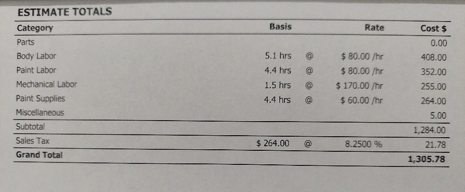

repair time
Dealer's labor quote = $80 - $170/hr
Santa Ana's labor quote = $65/hr across the board

Did they break the estimate down with labor and materials? , or just lump sum price it. The bumper may be removed to do it, not a big deal but adds to the labor. They may have to reinforce the repair from the back side.

I think you are looking at an hour to take the cover off, removing the sensors, and reflectors. Another hour to reverse that. Three hours of repair and paint, plus materials.
Posts: 12817 | Location: SWFL | Registered: October 10, 2007Reply With QuoteReport This Post
Does your vehicle have Blind Spot Detection? If yes, The Blind Spot Radar sits directly behind the damaged area shown in your picture. No filler material is to be used to fill any deep scratches or gouges as the difference in material composition can cause false or constant detection when no vehicle is actually in your blind spot. Also the Radar could have been knocked out of alignment causing improper detection which would require a radar installation angle check followed by a radar calibration for the proper repair.
If no Blind Spot Detection, then repair away however way you want without worry.

Blind spot is for detecting vehicles in your blind spot as you are traveling forward down the highway. It would be the small circular ultrasonic sensor that is located just above the reflector in the picture that detects stationary objects in its detection range.

Here are the breakdowns from dealer and from the independent shop. It's repair and paint, not a replacement.

Cost is about in line with the economy right now, 7 years ago probably 1/2 that. Pretty close between the dealer and indy shop, so it can't be too far off.

Those labor rates are both $40/ hr below what we pay around here. Expenses can be quite different regionally. Mistakes suck, but no one was hurt and money can fix this issue, while not a win it is far from a tragedy, best to get it fixed and move on. Sorry about your bumper, but as fuck ups go, I have done much worse, and am happy for you. Cheers!
