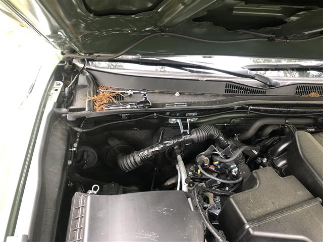

On-board air, a dual ARB compressor, under the hood. Slee Off-Road bracket kit. Install was relatively easy, 2-3 hours, not including wiring. It was a little tight getting some of the fasteners on, especially with my big hands. Wiring will be easy - when I did my off-road lights, I put in switches, relays and fuses for everything, so this should be simply hooking it up to what I've already installed.
Before:
After:

Did you make or buy a mounting bracket for the compressor?

I got the Slee Offroad mounting bracket for the compressor. Slee has been doing this sort of stuff forever, based out of Golden, CO.
