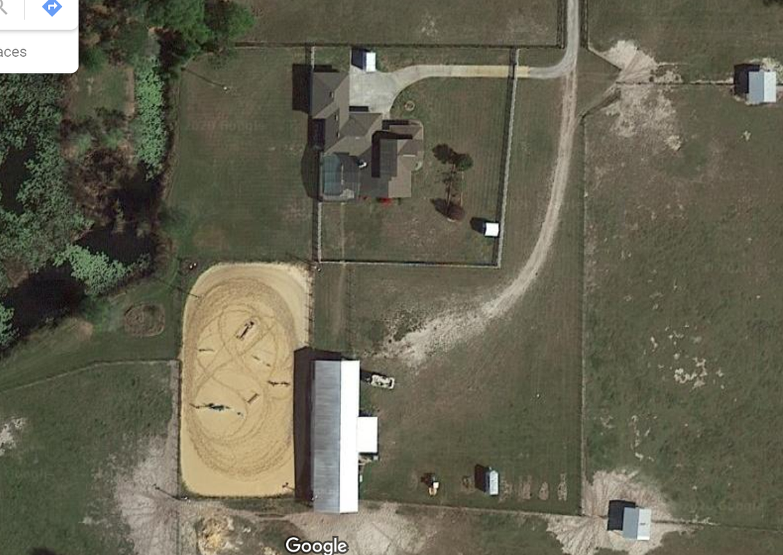

I would like to have an internet connection in my barn. A picture layout of the property is below.
The barn is on a separate electrical meter from the house with it's own panel, so there is no direct electrical connectivity between the house and barn and I am skeptical of those systems that use house wiring to move and boost an internet signal, and wanted to ask y'all for your help with this.
Distance from WAP in house to front of barn is 175'; distance to center of barn is 250'. Roofs of both buildings are steel.

The photo helps considerably. You have Line of Sight between the buildings, an unobstructed view between house and barn. There are a few options:
1) If there is a conduit between house and barn you could pull an Ethernet cable between the two. Maximum length of an Ethernet cable is 100 meters so you are likely within the distance. The house end plugs into your existing router, either the one you installed or the one the ISP installed. Everyone I have seen has at least 4 ports. The barn end plugs into a Wireless Access Point.
2) If you can’t pull cable, Long Range Repeaters like this will do the job. https://www.simplewifi.com/col...eatured-product-wifi. I have no experience with this company but the advice is spot on. If you go this approach go with a directional antenna. The downside is that they look like this: https://www.simplewifi.com/pro...riant=31229982376030. The upside is that you reduce the opportunity for signal squatting by limiting the scope of the signal to the direction of your barn.
3) I have experience with Ubiquiti gear, good stuff but introduces a level of complexity that you may not want.

I, too, used to do this kind of thing for a living. What members henryaz, TomV, smschulz, and stoic-one suggested: Either buried fiber-optic cable or a point-to-point wireless bridge.
The FO cable would have the advantage of the best possible performance. It would also be the most expensive and labour-intensive.
I would not run Ethernet cable due to the lightning susceptibility and the non-common power sources.
Personally, I'd probably use an Ubiquiti or EnGenius point-to-point wireless bridge.
Forget trying to use your existing WAP for the house end of the bridge. You want dedicated devices on each end, that are directional, and talk only to one another.
Since it's line-of-sight, with no intervening vegetation, a pair of these should work just fine: Ubiquiti Nanostation NSM5, 5GHz, 802.11a/n Hi-power 20 dBm Minimum, 2x2 MIMO AirMax TDMA PoE Station. You will want to mount these on the outside of the structures, facing one another. Thus you should use outdoor-rated Ethernet cable to connect to them. It need not be shielded, in this case, IMO.
(I only cited the Ubiquiti product because I'm familiar with the line.)
Then, if all you want in the barn is WiFi-connected devices, something like this EnGenius EAP1300 Technologies 11ac Wave 2 Indoor Wireless Access Point mounted centrally in the barn. (You'll need a PoE injector for it.)
(I prefer EnGenius APs because they don't need a separate management client, like Ubiquiti APs do.)
So:
house LAN <-> NSM5 <- air -> NSM5 <-> WAP in barn
If you wanted wired devices in the barn, as well, then add a network switch and plug the barn WiFi AP into that.
house LAN <-> NSM5 <- air -> NSM5 <-> switch <-> WAP
If you make the switch one with some PoE ports on it, to power the WAP, you won't need a separate PoE injector.
The Ubiquiti devices include PoE injectors.
