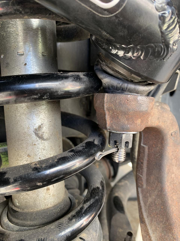

I leveled the Expedition back in May and was quite happy with the results and had no issues. A couple weeks back I started to get a pretty solid clunk on full drop. So I am presuming after I installed the new struts when I tightened the upper control arms full droop was not being gained but after 6 months of settling and flexing the bushings have softened up and now the inside of the upper control arm was making contact with the coil. No binding and only on extreme bumps but certainly annoying. I knew this may happen and I would likely need new UCAs to better the ball joint angle so they would last as intended.
You can see the inside of the arm contacts the top coil but the knuckle nor ball joint make any contact though they are very close.

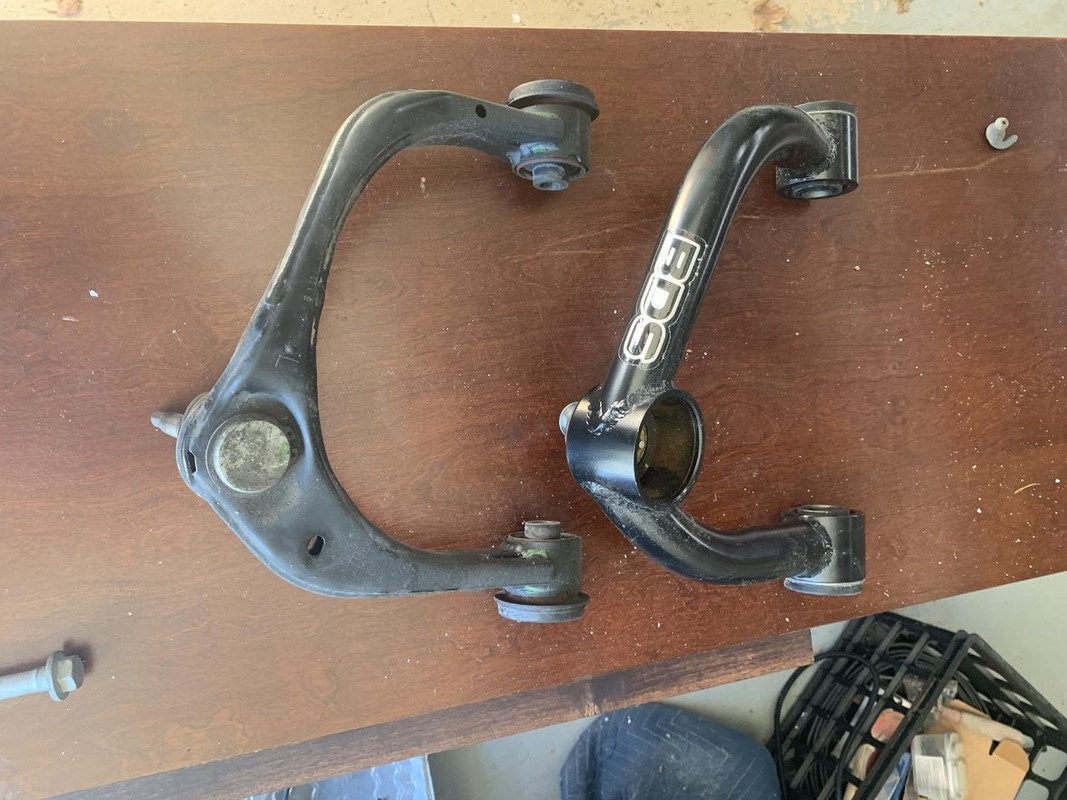

So I went ahead and bought some new UCAs that have a different ball joint cup angle helping to alleviate the issue or so I thought.

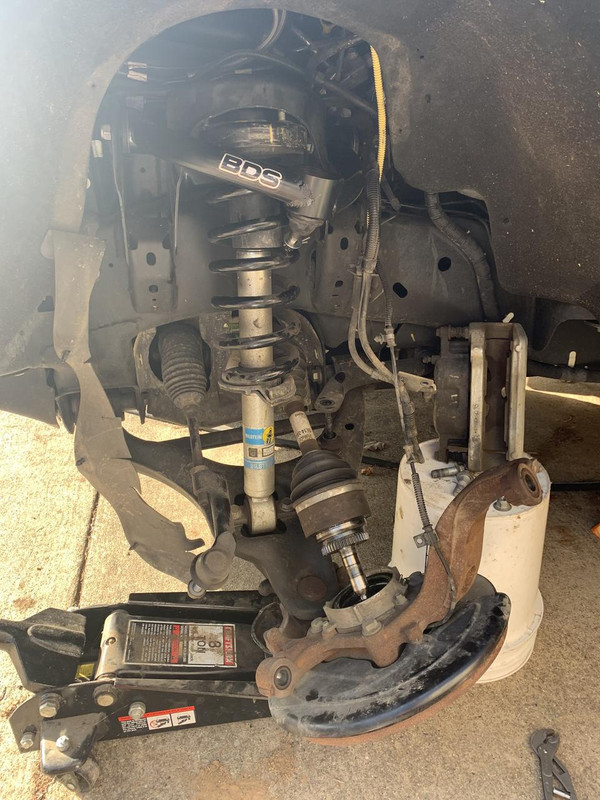

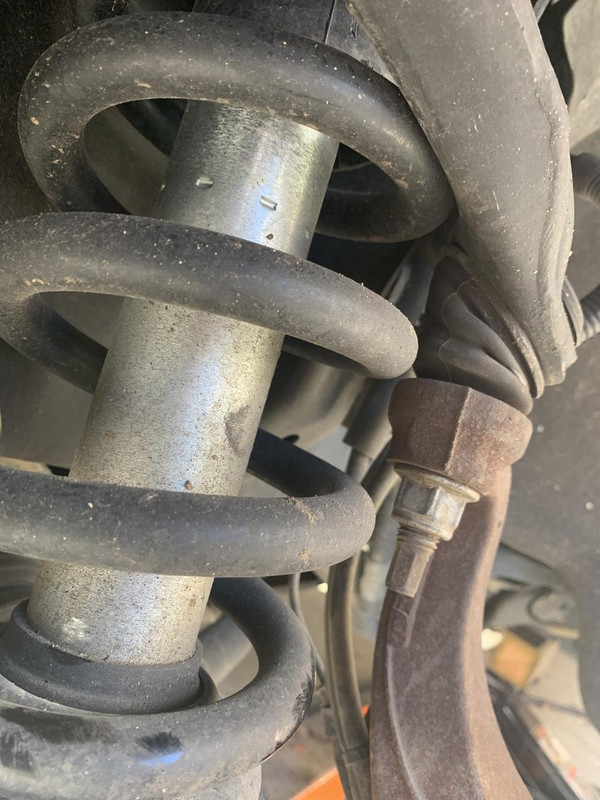

Well now the arm is clear of the top coil but the top of the knuckle is pushed down and in placing the knuckle inside the coil.
While the factory arm issue is annoying from time to time with the clunk that can't be heard with the windows up. It is not an issue driving as there is no binding. This on the other hand is not driveable since the knuckle is actually sliding under the coil.

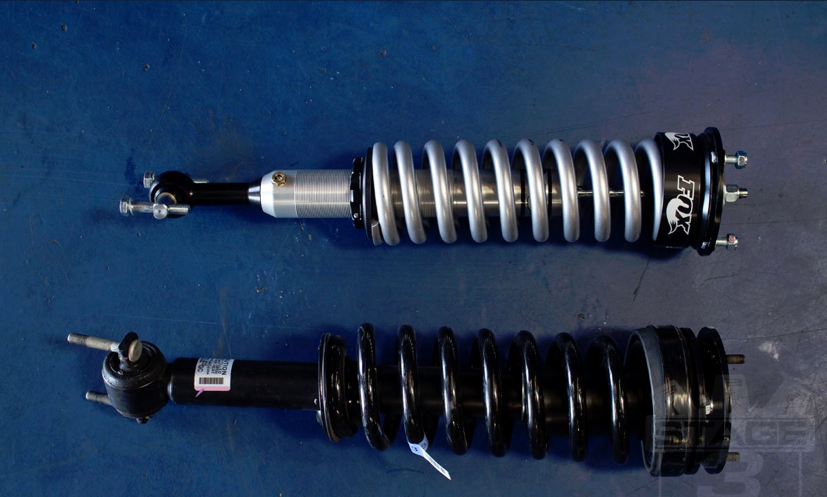

I broke down and read the instructions to make sure I did not screw up the install and they advise that these arms were designed to be used with Fox 2.0s and might work with other setups.

BDS makes a solid part. The factory arms may as well be folded coat hangers.

The Fox spring appears to have a pretty narrow diameter all the way up which is likely why they do not have the issue I am seeing.
