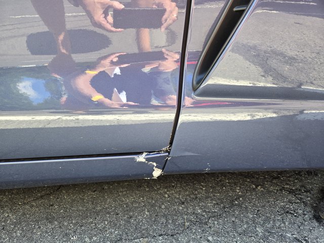

I have a 2013 Corvette 427 Convertible. While they only made 2551 of these, the components I need are common to the Z06 model C6. Car slipped off a floor jack and damaged the R/F fender, rocker/sill panel and just nicked the door. All three components are discontinued.
The estimate was $12.8K and that was assuming the parts were available.
