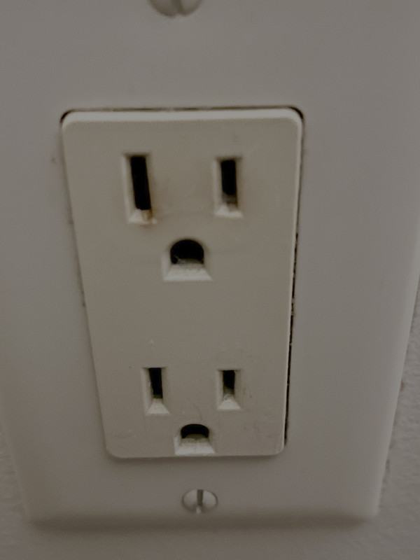

So I have a significant sized wall mounted electric space heater for my master bedroom that I plug into the outlet 3 feet away, and I noticed today that when my heater was running, I just happened to look down and noticed the plug halfway out of the outlet with the prongs exposed, but still connected and the plug head was really hot to the touch. Is this why the plug was hot because it was a loose connection? I didn’t see any damage and I smelled no burning or anything, but could have I damaged the cord or the outlet? I don’t ever remember the plug getting hot before when I unplugged it after use, but it was always all the way inserted previously.

Being partial out could have caused the heating of the plug.
I would replace the outlet if you’re handy.
Do you have an amp draw meter you can use to check the heaters health?

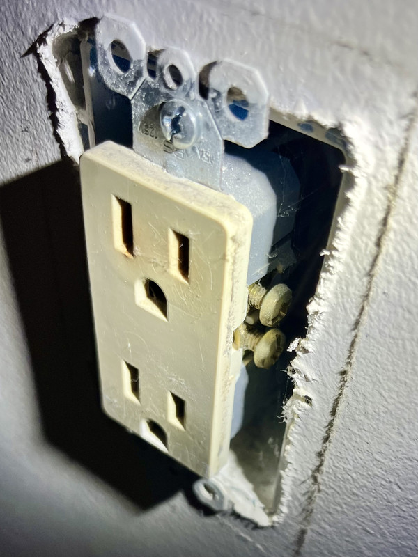

Yeah I think I’ll replace the outlet. I guess, when I first saw the outlet, it was a little darker in the room than I thought, as with a second look with a flashlight, I noticed this charring on the left slot with what appears to be a tiny bit of melting from the heat.
I showed some pics to a family member who is an electrical engineer and he said it’s better to install outlets with the wires around the side screws instead of hooked directly in the back. He said sometimes houses are built this way to save time and although it’s functional, it’s not as solid of a connection as using the side screws. I have no knowledge on the subject, so I take his word as Canon with electrical things. I figured I would still ask on here though to get a broader spectrum of opinions.
Here’s a couple pics

Your family member is right about back stab connections. They suck. Use the screws.
Also, it’s not uncommon for 1500W space heater plugs to get warm while in use. That right there should tell you something about space heaters.
Is the circuit on a 15 or 20 amp breaker. Anything else on it.

Yes the outlet needs to be replaced. There's visible heat damage to the plastic.
