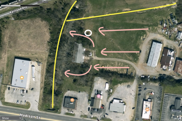

Picture of cparktd
White circle is location of my sink-hole.
Yellow is drainage ditch and a small wet weather creek
Orange lines show lay of the land and current water flow.
The building closest to the hole is my shop... It is 50 x 100 feet for scale.

I can give you my "geologist from afar" perspective based on your description. Given your location and the size of the hole, that is almost certainly related to karst. What you are seeing at the surface is likely the "tip of the iceberg", so to speak. Karst sinkholes will often narrow from the surface to a throat of stronger material and then open up again below. Think hourglass shape, but with the bottom part usually significantly bigger than the top part.
There is no getting rid of the sinkhole. If you're in middle Tennessee, there's not enough grout on God's green earth to fill it. Instead, the most common solution is to plug the top with an inverted filter of graded stones and geotextile that will allow any water that enters to filter through while keeping additional soil from washing in. Your idea of diverting water is good, but only if you can divert it far from the hole. Give it a wide berth, and direct the water away from any structures. If there is a large solution cavity beneath the hole, moving the water could just cause a new sinkhole to open up. Better to dance with the devil you know.
Those are general guidelines from a licensed engineer and geologist, but I'd be hesitant to make any more than general suggestions without actually laying eyes on the property. I would contact a local university or the state geology board and see if they have someone willing to come look at it. I've looked at sinkholes for people near my college, and usually there is someone willing to help. Local knowledge is always best in these situations.
