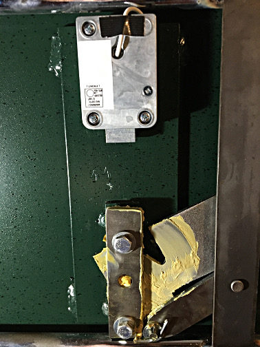

Won't work on yours. Once the boltwork moves out of the way like that the swingbolt will extend and lock, locking your safe in the open position and becoming stuck that way. Same problem with a solenoid and motor operated square bolt. Once the lock cycles it will automatically extend the bolt and trap the boltwork from closing.
Your only option is a mechanical lock or electronic lock with manual retraction/extension.

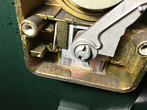

Originally posted by a1abdj:
The lock in your safe isn't that great of a lock. I suspect if you pull the back cover and open up that lock you'll find black "dust" which is the metal of that particular lock wearing out.
Unsurprisingly, he called that one right:

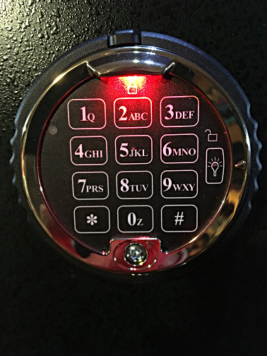

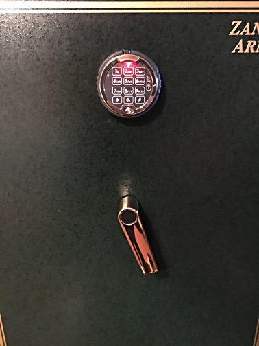

Got the new Sargent & Greenleaf Titan D-Drive electronic lock installed Saturday.
(I haven't put the S&G logo over that screw, yet. I'll do that today.)
With the gold trim on the bezel, it turned out to be a pretty good match to the safe's handle and trim paint.
a1abdj was right on this, too: The install was pretty straight-forward. One tricky part was getting the old lock off, which wasn't immediately obvious. (Surprisingly, I could find no YouTube videos for that.)
Another tricky part was getting that cable that goes between the keypad and lock into the cutout in the spindle. Finally applied a small amount of Vaseline petroleum jelly to the cable and it slid right in. I then wiped it off the cable jacket.
Another installation hint: I cut the spindle slightly long to leave some material so I could smooth out the rough edges with a file.
Wouldn't you know it: It was only after testing the lock several times Saturday, then putting the back on the door Sunday, that I discovered why the old lock had occasionally been reluctant to lock: The lock bolt was a couple thousandths off from the slot in the safe's lockwork when the safe's handle was turned fully closed. A couple minutes with a Dremel tool to slightly relieve the edge of that slot and new lock now operates smoothly in locking.
I've been testing the lock several times/day since installation, with two different combinations that, between them, hit all the numbers on the keypad. I think today I might finally be comfortable enough to actually lock the safe closed

After 32 years do I need to have the lock "serviced" or cleaned in any way? Seems to still operate as good as new. Please advise and thank you.
Technically you're a bit past due. Wink
A few weeks ago I was contracted to move two very high end jewelers safes out of a multi floor office building. It was going to be an expensive job as the safes needed the doors removed to keep us within weight on the elevator, and the owner really only needed one of the safes. She offered me one of the safes in exchange for moving both of them out.
The safes were identical, and I asked her which safe she wanted of the two. Her daughter commented that the one she was giving me was always difficult to open. I popped the cover to set it to a storage combination and discovered that all four lock mounting screws were loose. This allowed the lock to move around, thus making the combination difficult to accomplish.
She thought she was taking the better safe, but the one she gave me was in better shape due to the lack of use. Had one of those screws become detached within the lock it could have been a lockout situation costing several thousand dollars to rectify.
So even though the safe was in outstanding condition and the lock was in good condition, my inspection caught a problem that would have occurred eventually. The lock was also giving them signs that something was wrong.
Moral of the story is that it's not a bad idea to have something inspected and serviced, even if everything is working properly at the moment. You never know what issues might be discovered and rectified. Loose fasteners do cause lockouts.
