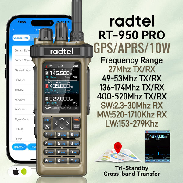

The new Radtel RT-950 Pro
It really does it all. Features like GPS/APRS not available outside of the big name Japanese radios (Yaesu/Icom/Kenwood) and even those don’t have everything this does in one radio. Also has NOAA channels and will even TX/RX on 6m band (50mhz).
Also has a spectrum analyzer and cross band repeater functions.
$96 on Amazon. Reviews look good, I grabbed one for $77 last week when it was a lightning deal.
After playing with it a few days my initial report is this:
~Solid construction, heavy duty case material and a bit larger than my beloved TIDRadio TD-H8. Absolutely no comparison to the cheap Baofeng models.
~NICE Bright and clear color LCD screen broken into three sections for tri-watch capabilities or to show GPS position and APRS info.
~Good audio
~Easy to program manually or use a phone app via BT.
~5 Banks of 64 channel memories to organize programming.
~2600mAh USB-C Charging battery and can use radio while plugged in to charge.
~Good size keypad, with 10 or so user programmable hot keys for single button access to favorite features.
At the regular price of $96 it is a hell of a deal on what looks to be a solid radio. At $76 it’s a downright steal. I checked a few reviews before ordering and it is getting good press.
To take advantage of all the features, you’ll need to invest in a few additional antenna.

Heads-up if anyone is looking at the model on Amazon: The one I received today can't be programmed in the 6m band (50-54MHz).
In fairness, it looks like the Amazon product description has been changed and makes no mention of 50-54mhz. The manufacturer's page is pretty clear that 6m -is- reachable, so possibly a different version is being sold direct.
So-- visualize "sad trombone music" here-- off to their website for me also.

“Menu”
“Radio Set”
“Work Band”
“18-64 mhz”
Make sure you have an appropriate antenna as the included one does not work at those frequencies. Try to Tx without proper antenna could damage radio.
