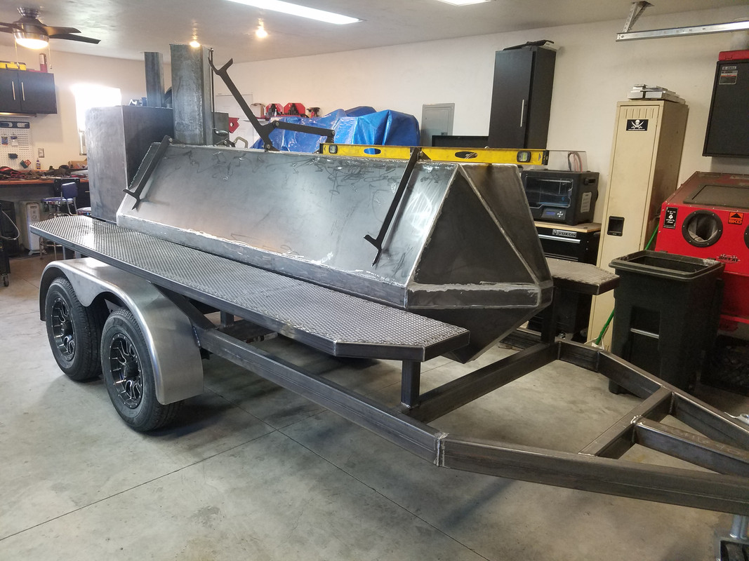

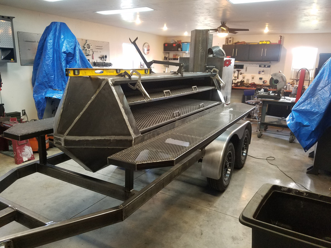

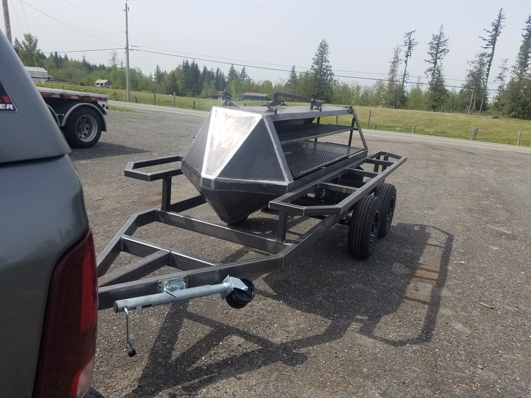

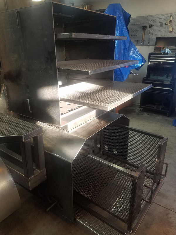

Should have insulated a he fire box. Will help maintain temps in colder weather and rain.

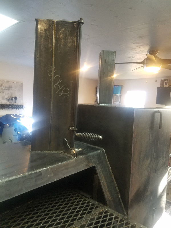

The part of the firebox directly above the flame has an insulated chamber, used to capture heat and conduct it up to the warming cabinet. The sides and bottom aren' insulated.
I can double wall and insulate the sides of the firebox any time i like, should the 130',000 btu/hr firebox be insufficient to heat a cook chamber that requires 30,000 btu/hr to heat.
Ill just have to see how it works, then compare the cost of wood to the cost of steel plate.

It came out beautiful. What color paint? What kind of vertical mill do you have? Oh, and you've a engine lathe hiding in there some where.

Wow! I'm curious what something on that level cost.

Im going to paint it with Rust-Oleum 1200° bbq grill paint, in semi gloss black.
Theres a Precision Mathews PM935 mill, a Birmingham 13x40 lathe and an Optimum CNC vertical milling center hiding from the grinding dust under tarps.

The customer im building it for, is into it for 7000$ in steel plate, axles, springs, wheels and tires, welding gas, wire, etc. Since the steel tariffs have kicked it, steel prices are way up.
I'm into it for about 300 hrs of labor.
A new smoker this size and so-equipped will typically cost about 10,000 or more.
A shop set up specifically to manufacture smokers can bulk purchase to get the steel costs a little lower and build fixtures to reduce labor costs.

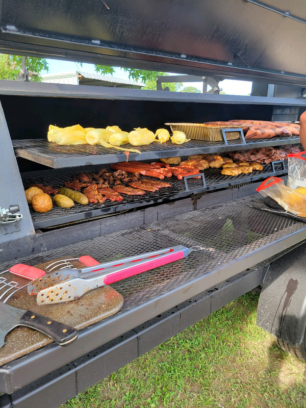

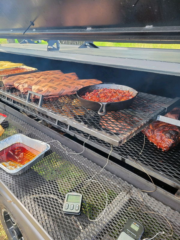

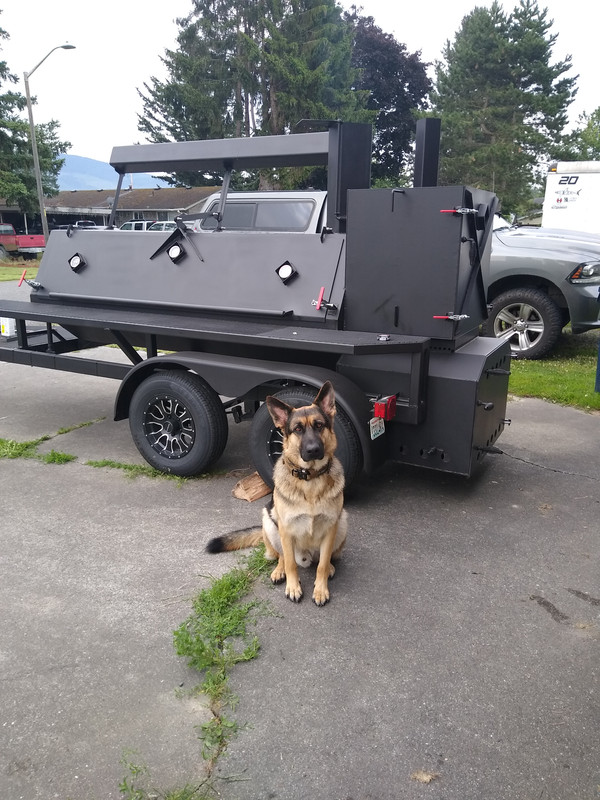

Just a quick follow up on this 3 year old thread.
The smoker has been running like a champ for 3 years, and produced lots of good stuff.
With protection!
Notice the security guard I the background, eyes
Bugging out and waiting impatiently for his security fee!

Impressive, but it is too heavy. After all that work, he will some day say it is too heavy, and needs a lighter one.
When actually what he needs is a bigger truck.
