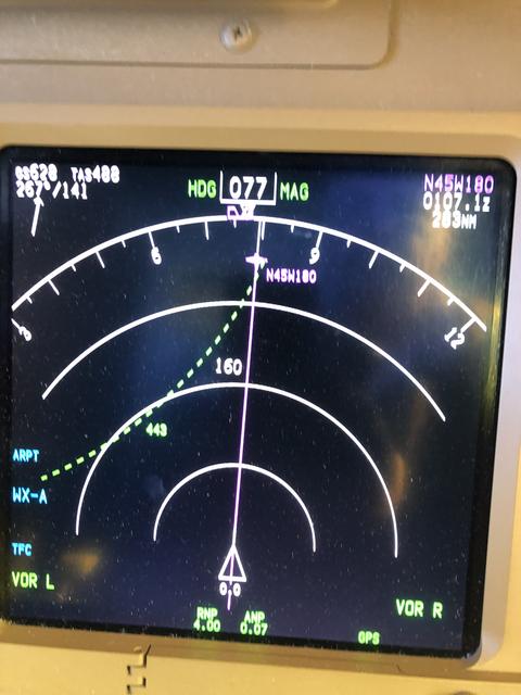

This was yesterday over the Pacific, approaching the international date line.
141 knots on the tail, which is 162 mph of tailwind. Fairly common in the Pacific.
Amd what sigmonkey said is correct. .82 Mach is .82 Mach for the airplane - it does not care if it has 100 knots on the nose or on the tail.
